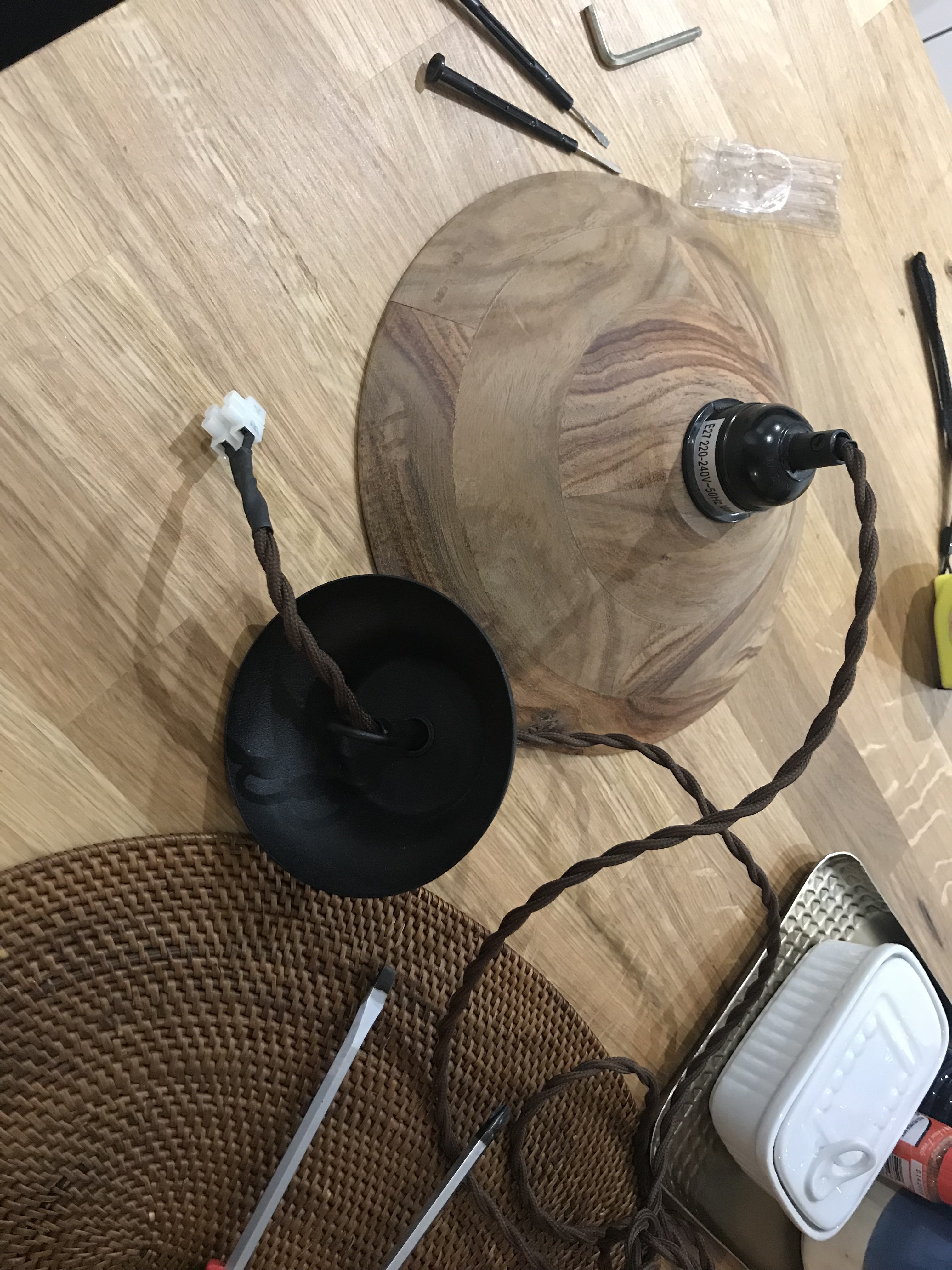

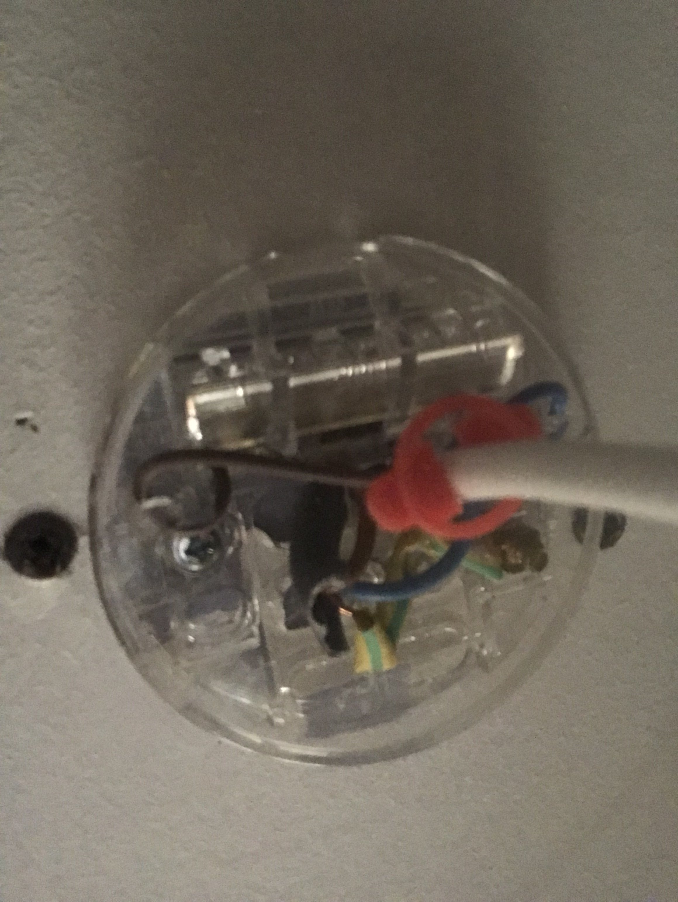

Hi! I’ve bought new pendant lamps (see pic 1and 2) and was replacing them when I realised they don’t have an earth wire terminal (but the wiring in the ceiling does) - see pic 3.
The light doesn’t say it’s double insulated (it doesn’t have the symbol) - how can I tell otherwise?
If it is, do I just add a terminal block to the additional earthing wire?
Thoughts greatly appreciated!
if the actual,light has only a 2 core flex, it does not need earthing. unless it's a cheap grey import.

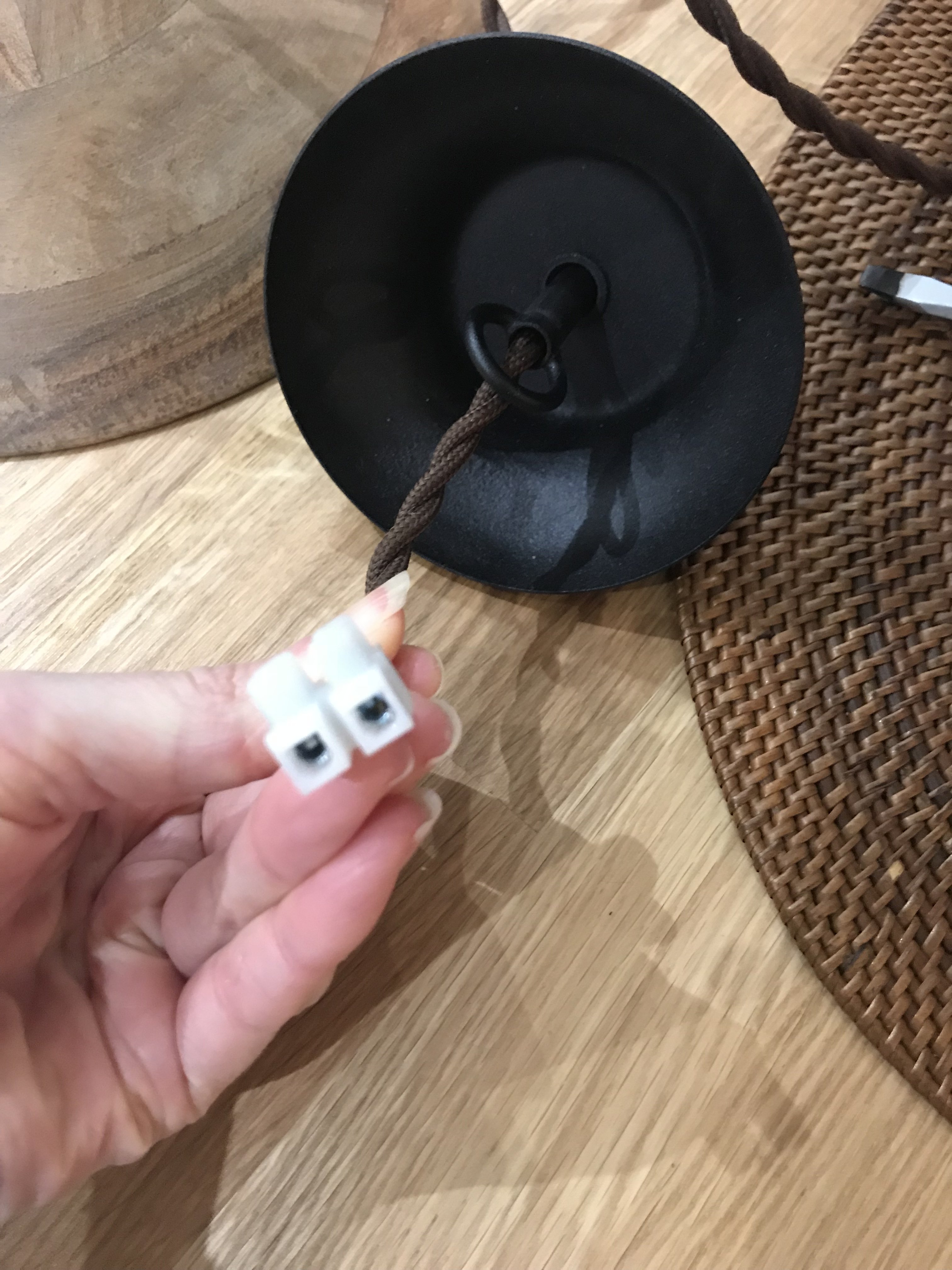

Is there another part to the fitting? Where does the metal ring hang on to? Have I missed something obvious? Too many questions, sorry.
Not at all! That’s all it came with. I bought a basic steel suspension bracket which I can use to hook the black ring to (which is vertically adjustable).
I'd go with westwards idea - otherwise you will just end up with that bare connector block floating around, which is not safe.

I wonder how many of these lights have been installed in a less than satisfactory way because the person fitting it didn't have an understanding of earthing/double insulation.
