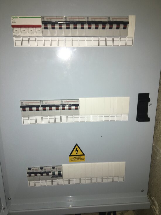

As above,I do work for a fabricator of hot food counters and they need a 3ph db to fit in a cupboard about 500wide x 300high.I have found a proteus unit,but would prefere another brand.In the past a din rail box has been used with mcb,s hard wired to a main switch,but I believe there is no warranty with such a unit.Thanks for any help.

CA38DE77-098F-4C97-A39C-0920F0B22347.jpeg Yes Schneider do them. Although this picture is of a 3 row DB it will give you an idea of its appearance.
I'd go Proteus also. If they don't have one off the shelf that will fit they can manufacturer for you (made in England). No idea on cost tho
Had a similar enquiry recently and opted for the Hagar unit (Good board, easy to work on , 'fit for purpose'), but wasn't aware Schneider made one though as may have opted for that (depending upon the cost as probably double that of the Hagar when fully loaded!).
