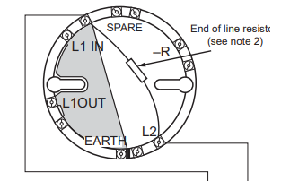

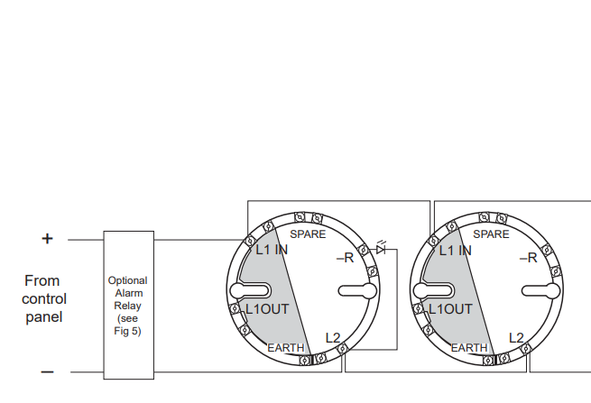

Hi, I need to extend a fire alarm, the panel is a CTEC CFP 2 zone one and currently it has a couple of apollo alarm sense sounder bases/heads on it. I fitted 2 extra normal (non-sounder) alarm sense bases and alarm sense heads but the panel is showing a fault on that zone, the fault clears if I bypass the two conventional base's. All the heads work on the sounder bases.
Are the alarm sense conventional bases compatible with the CFP panels because the instructions just show a diode base in the wiring diagrams, if they aren't then why do the alarm sense sounder bases/heads work ok.
Edit - I've just checked the CTEC site and it does say the panels are compatible with the alarm sense stuff. Why would it show a fault then if it clears when you bypass either base, they are definitely wired the correct way round. The bizzare thing is the panel still shows a fault if you put the end of line capacitor in the panel along with the fire alarm circuit if either base is in he circuit it that makes sense.
Edit 2 - I didn't get any instructions with the bases as they were just loose in the package but apparently you don't wire the alarm sense bases across L1 and L2, both browns go in L1. Fancy having an L2 connection then, its just inviting trouble, luckily they are only £3 each.
You are not the first, those bases are horribly confusing.
A normal base:
+ zone to L1 IN , both in and out
- zone to L2, both in and out
DO NOT USE "L1 OUT" FOR ANYTHING, however tempting and logical it seems
A sounder base has two sets of L1 and L2 terminals, and an L1 IN and L1 OUT.
+IN L1 and -IN L2 to one pair
+OUT L1 and - OUT L2 to the other pair.
I used to hate these systems so much....!
That strongly suggests a wiring fault.
To avoid going mad, I'd rig up two short bits of wire with both bases, heads and an EOL and try connecting that directly to the panel zone. If it's happy there, it will be happy when integrated with the existing zone, but obviously remove the EOL.

Yea, it crazy, I'm no expert on fire alarm panels by any means but I know sounder bases and beacons are sometimes wired differently on various make panels but I thought a base was a base, you either split the -ve or the +ve wires depending on the make across the diode. They have obviously just used the older conventional base and updated it by screwing newr stuff to it leaving the older terminal identifiers in place, I did read the instructions for the sounder base so understood not to connect anything to the L1, L2 etc but unfortunately I didnt have any instructions for the normal bases but I thought how hard can it be.
Also the sounder and beacon bases are pain in the arse to fit, the screws are hidden way too deep in the mechanism to even see what you are doing.
