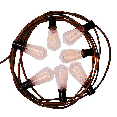

I remember my father making a set of outside christmas lights using coloured "pygmy" bulbs (I apologise if that is a non-PC term). basically, there were a couple of dozen of them, and they plugged into bayonet holders. The holders themselves were in 2 parts. the bottom part had a channel with 2 sharp brass prongs set apart just the right distance to pierce a T&E cable. You laid the cable in the channel, over the prongs, then screwed the top half down on top, squeezing the cable tightly, then the prongs penetrated the outer sheath and inner insulation. Not sure if such fittings are available nowadays....anyway, they lasted for years, and I only threw that set away a few years ago, so they had lasted for at least 50 years, albeit only being brought out at christmas. One advantage was that they seldom needed replacement lamps, despite being used outside, on top of the garage, in all weathers.
The leading brand of cable-piercing festoon holder was 'Beeantee' - they are still made although IIRC by a different firm. The cable looks like T+E but it's a purpose-made 2-core 2.5mm² stranded festoon cable. see:
Festoon holders from David Rose Lighting
I came cross one of these exact items before. I understand they're still available - I imagine they may be a fit once, non removable variant though - and are used by manufacturers of festooon lighting. designed for use with proprietary festoon cabling.
The ones you describe are still evident under the canopies of a few shops in my town, made exactly as you describe, screwed into lengths of T&E, with various attempts at connecting them up to the mains by shopkeepers of yesteryear. Only one set actually still seem to be in use.
