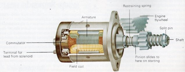

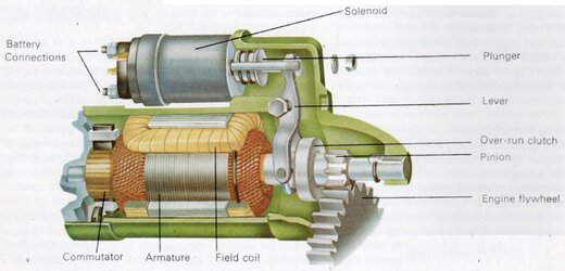

What type of starter motor is it ?
Is it a bendix type where the rotation of the starter throws in a gear which connects to the flywheel ? These can have problems where the gear doesn't disengage properly and spins the starter motor.
You can usually tell as to the type you have, as the solenoid is separate from the starter motor, usually bolted on the bulkhead.
The simplest way to test is with a lamp tester, as you can easily disconnect the ignition supply and or solenoid /motor supply to test.
