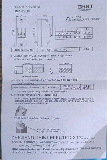

Hi all, working at a house where a British Gas have installed a Chint iso off their meter.
The isolator is a Chint NHB2-100UK 100a unit but Google and Chint’s own website are unable to bring back a spec sheet for the switch (photo attached).
Does anyone know what torque the terminals need tightening to? Also where to find a 3mm / t15 torquing tool! Cheers359604B7-3E12-448A-8178-F57C250B7452.jpeg

Well, to my amazement here’s the data sheet in case anyone else stumbles upon this thread!
. . . and mainline was correct it is a piece of tat from China.
Resurrecting this because I have encountered one for the first time, it had to be this tat didn't it!
Looks like it is a British Gas standard fit, this was British Gas installed also.
The only source of info on this was this forum and struggling to find a hex tool to torque, just did what davesparks said and hand tightened it. Spent a load of money on a torque screwdriver set but they don't do a hex attachment! They like making it hard for us don't they!
Thanks GarethB for the datasheet
