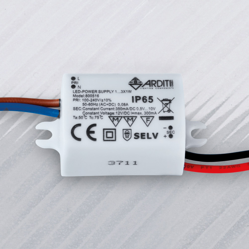

That is very small, the smallest ones that are readily available are 55 x 22mm. Like this one for example. Are you sure it's only 10mm?
Here's another small LED driver, just for ideas :)
Universal LED DRIVER 3W 350mA external LED power supply IP66 constant current | Liminaires - https://www.liminaires.co.uk/ad401327-universal-led-driver-3w-350ma-external-led-power-supply-ip66-constant-current.html
Guys, thank you. I confess I had no idea transformers could be so small. But, of course, I was originally thinking in terms of powering three 15w halogen lamps. I think with a bit of digging into the plaster, I might be able to accommodate one of these LED transformers supplying three 1-2w capsule LEDs.

In surveying LED capsule G4 lamps, I found a warning that 12v as usually supplied to halogen lamps was not true DC, and that some (all?) LED capsule G4 lamps would not work. What's the truth of this? And I don't need them to be dimmable - should this affect my choice?

Halogens work fine on both AC and DC 12V and the transformers usually provide an accurate voltage. The only proviso is that LED's may present too small a load for an electronic inverter to work correctly. Electronic drivers usually have a min-max range and taking too little power may make them unstable.
If your LED takes power in the specified range of the driver it will work, they don't need DC and will work over a much wider voltage range than halogens. They should be fine.
