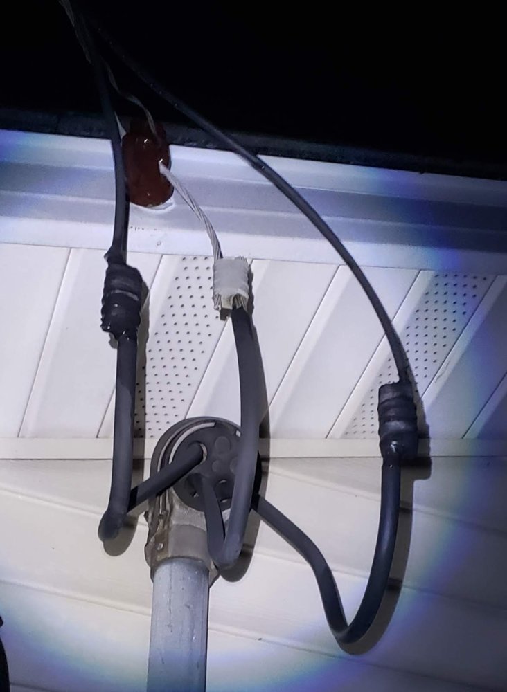

Outside a single line comes from the pole at the road ~120 ft where the main line continues to our neighbor's and a smaller line splits off to our house, each about ~60-75 ft.
  • Here is where I think the first problem may be as the line coming to our house is only about 6-8 gauge off the main line shared with out neighbor's which appears to be 4-6 gauge.
Then the the wires tie into 4 gauge wire at the head before going to the meter. (see pic)

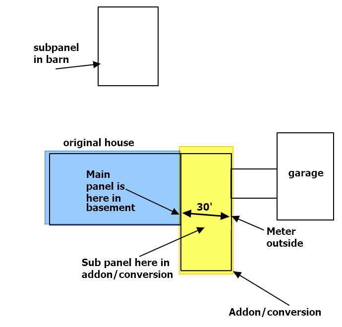

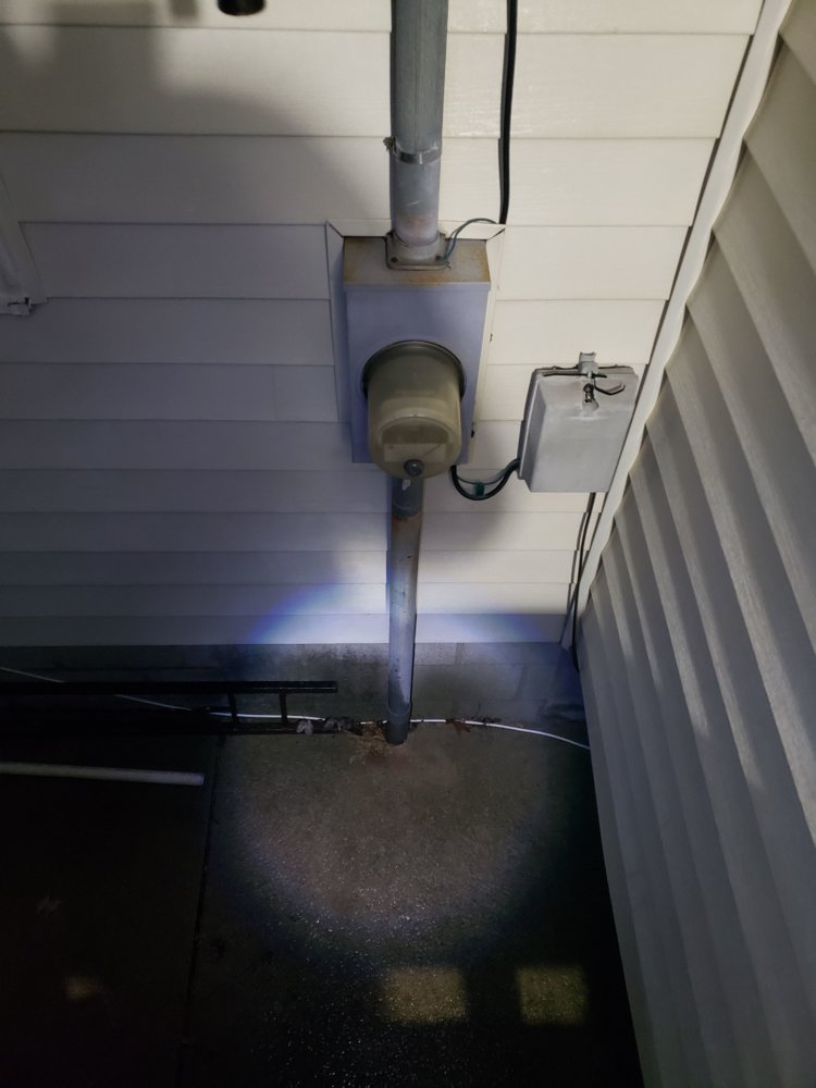

Next from here, the 4 gauge wire runs ~30 ft to the main panel in this conduit.
  • Here is where is I think another possible problem may lie. The line comes in on the other side of what I believe is either an add-on, or the old garage converted to living space. I am not sure if this is too long from the meter to the main panel. I am not sure if the meter outside was moved, or it was always here, but it does not appear that the meter or the panel were ever moved. However, the previous owner did not do this add-on/conversion so I cannot say for sure. Based on my research, it has been 20+ years since it was done.
This add-on has its own 100 amp sub panel as well. There is also a 100 amp sub panel in our barn.

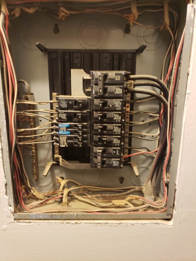

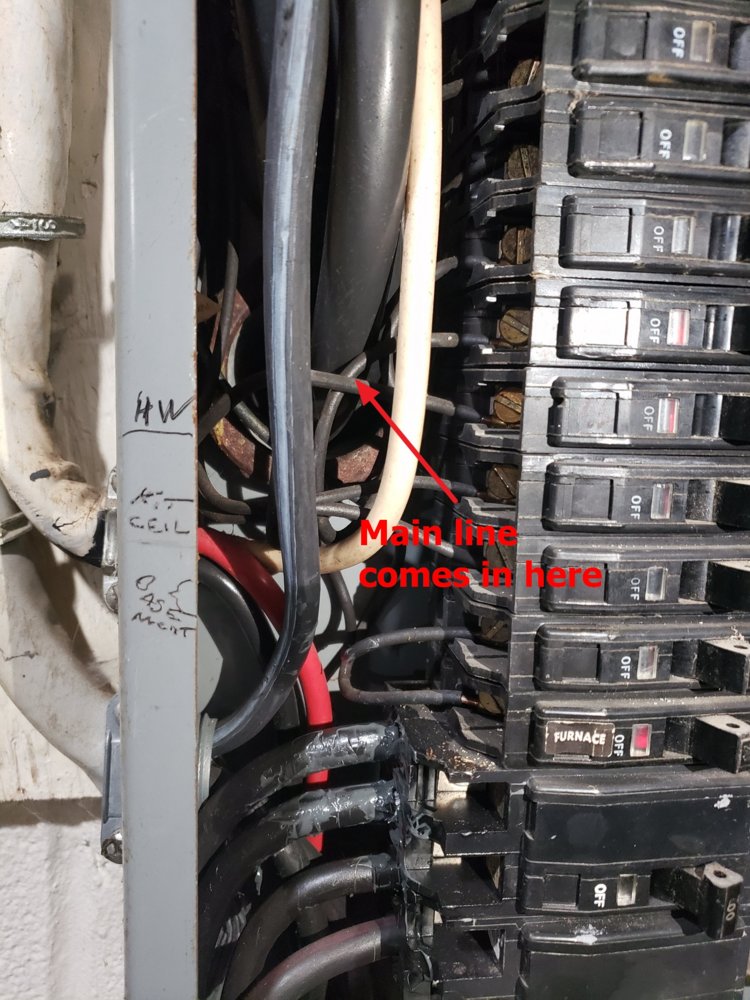

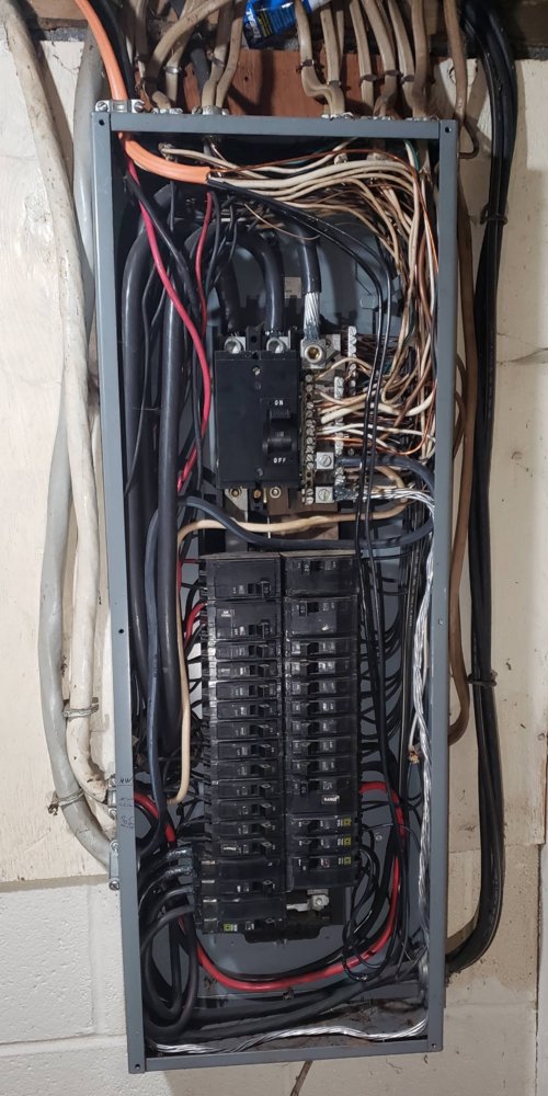

Finally here is a picture of the two panels in the house, the main and the sub in the add-on/conversion. I can get one from the barn if needed. Any thoughts?

football welcome to the forum and to start with the power company is not going to change the wire size because it can withstand more amperage in free air which keeps it cool. I suspect you have a loose connection in your main panel on the main lugs Yes them panels look like crap but they are still doing there job. Call an electrician to come over and check you main connections. Even though the power coming in is feeding 3 houses that will not effect you. Good luck
