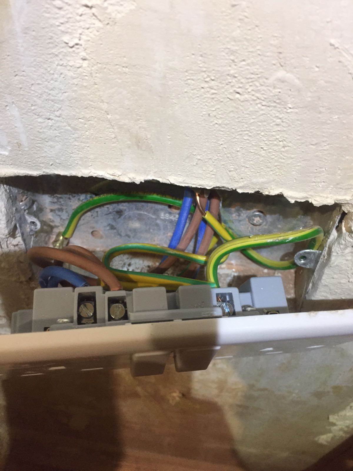

Hi i was just after a bit of advice, when wiring sockets how much of a problem is it when the earth sleeves are too short and don't cover all the conductor? will it affect testing etc?
If the sleeving is too short then you have an increased chance for the bare cpc to come into contact with a live terminal.
Testing wise it would only be a problem if the cpcs were in contact at the cable entry when you had separated them at the terminations.
Generally not too much problem, just does not look too good and makes you wonder about the rest of the workmanship.
(Operationally it is easier to get a test probe on the earth!)
