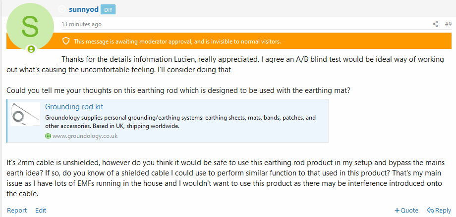

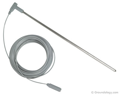

Could you tell me your thoughts on this earthing rod which is designed to be used with the earthing mat?
It's 2mm cable is unshielded, however do you think it would be safe to use this earthing rod product in my setup and bypass the mains earth idea? If so, do you know of a shielded cable I could use to perform similar function to that used in this product? That's my main issue as I have lots of EMFs running in the house and I wouldn't want to use this product as there may be interference introduced onto the cable.

It doesn't make sense to use shielded cable for an earth connection, because the main method by which shielding works (e.g. to stop car ignition systems causing crackling noises on your stereo) is to surround the important conductor with an earthed one. So you would be shielding an earthed wire with another earthed wire. There are lab techniques where this is necessary but it is not applicable to your earth mat.
It would be like trying to wash tap water off a surface using tap water.
