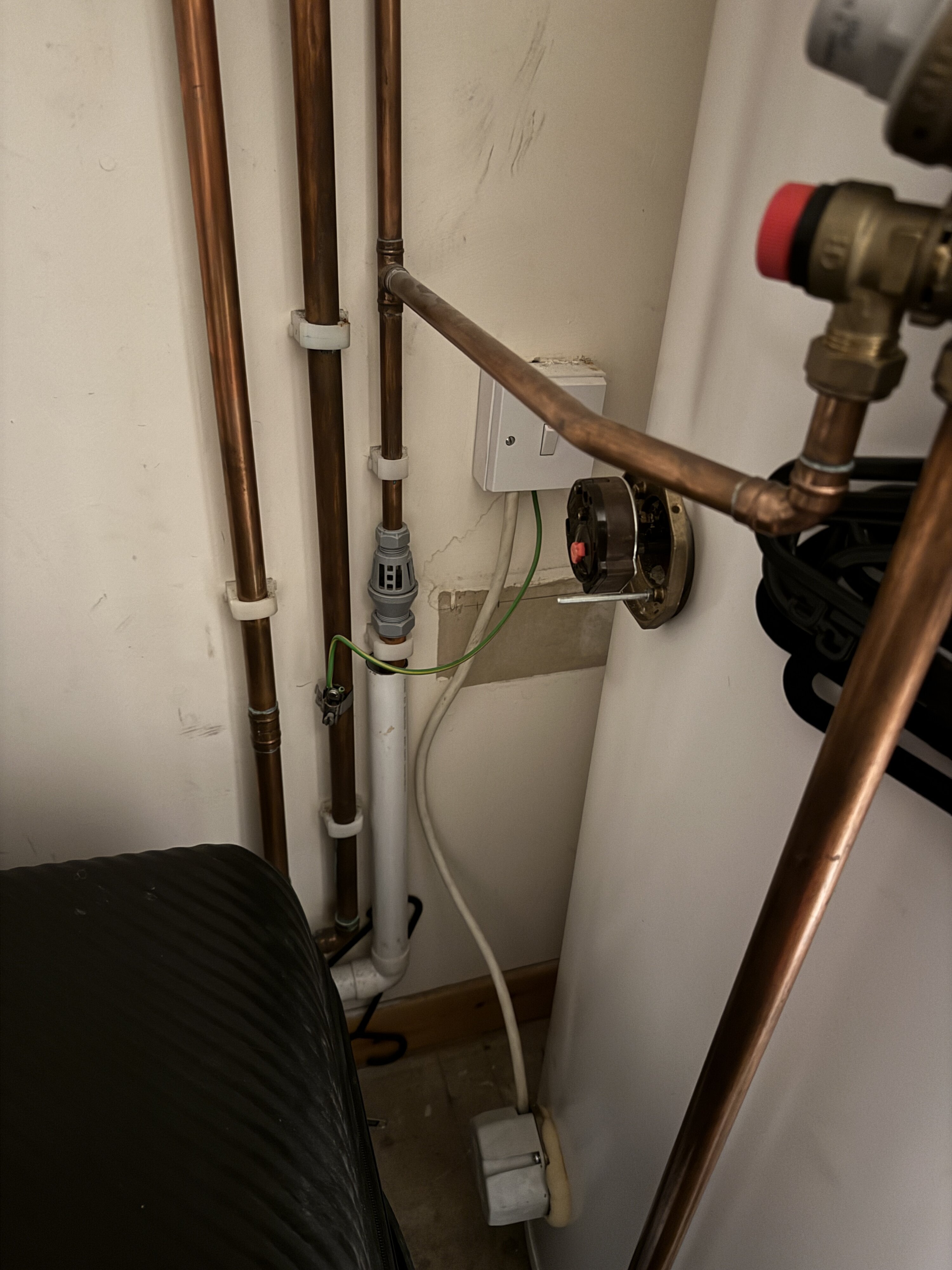

We have just moved into our new place and it is all electric running a economy 7 set up.
I have done some looking and it seems I want my off peak switch always on and keep the on peak switch off. My confusion is nothing is marked.

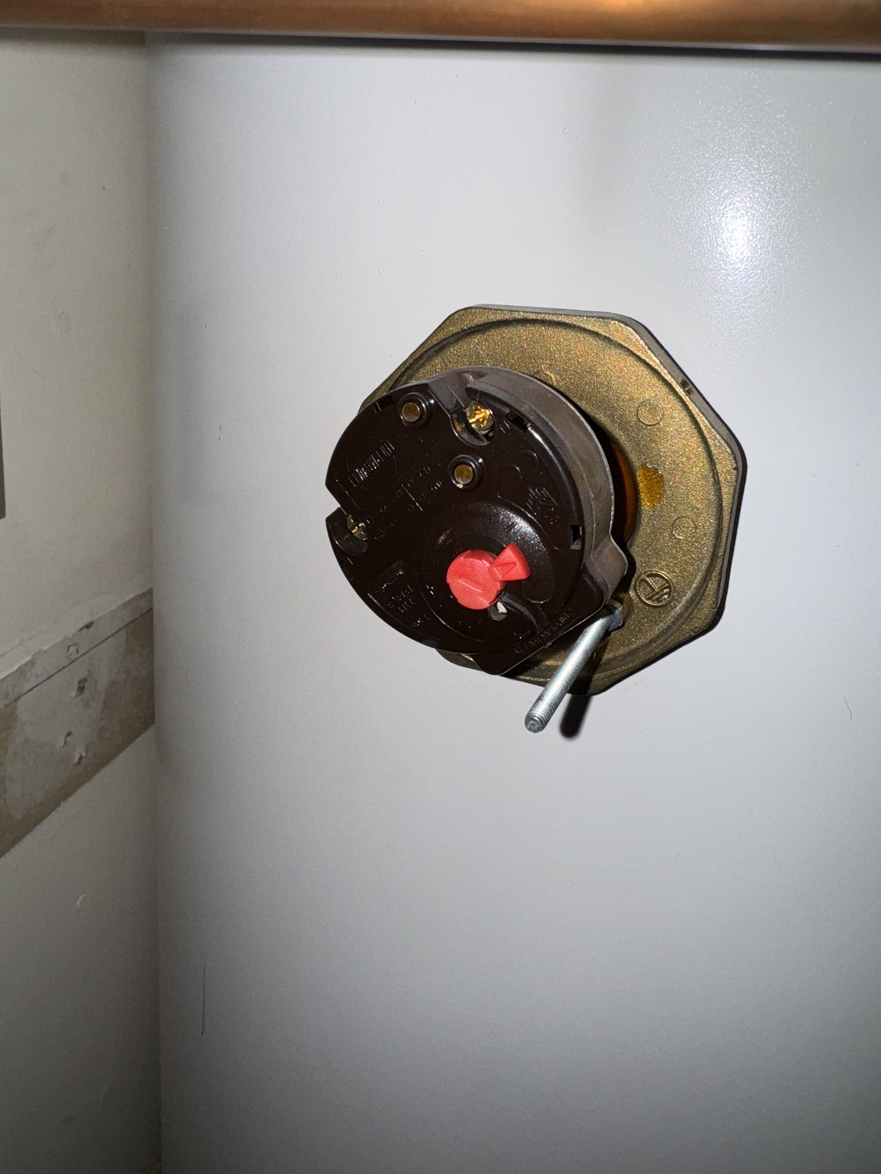

I have attached photos of the water heater with the only switch I can see turned on. This looks like it’s the off peak as it’s coming from the bottom of the tank? Located in the bedroom closet.
The only other switch is next to the economy 7 controller box which is currently off located in the kitchen. The box is on but it is just dim lighting so the display looks off.

If you are concerned about minimising your electricity bill, ideally you don't want the bottom immersion consuming peak rate power. So you need to find out how the immersion is being fed, hopefully from a power source that is switched - either an off-peak consumer unit ('fuseboard') switched by the meter, or the timer unit in the kitchen (or possibly a combination of the two!). If the switch on the wall feeding the immersion has a red neon indicator that's going to help, if not it might be useful to fit one.
Can you tell us what you have by way of consumer unit(s) and meter. Photo's would help. Is there a circuit breaker marked 'immersion'?
If you don't have an off-peak consumer unit, you will need a working timeswitch. I think swapping the body of what you have is a straightforward DIY task (with power off!)

That Newlec timer/switch will need to be left switched to "timed" for the offpeak to work - also worth checking the times it's set to actually line up with your offpeak tariff. The boost button utilises the 24 hour supply to boost the heat if you were to run out of hot water, typically limited from 30 min to 2 hours. In your case the bottom element is being used for offpeak and boost, which isn't an uncommon setup on smaller tanks.
If you wanted to utilise both elements you'd either have to run a second switch wire from the switch position to the tank cupboard or rehome that switch in to the tank cupboard.
There is a couple of benefits to this -
redundancy - if the bottom element fails you have an immediate backup with the press of the boost button.
Again in the event the bottom element fails, it's possible boosting the bottom element, even set to 2 hours, is incapable of heating that entire tank from cold to a reasonable "hot" temp. If you were boosting the top one for 2 hours it's almost guaranteed to be hot but you'll have less volume.
These immersion elements have stats in them so they regulate themselves. If you don't use that much hot water in a day, not that much heat will be lost so it'll only be doing a small amount of work the next evening to top up.

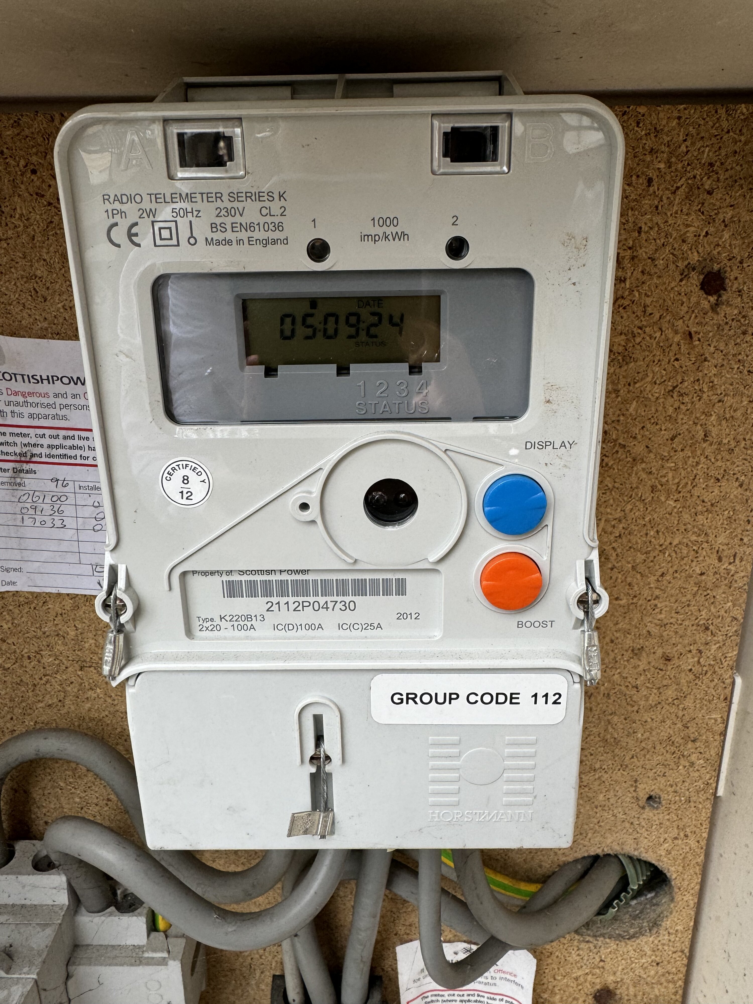

We do have 2 storage heaters, never been used and both are turned off at the wall. I have attached pictures of the meter outside? Sorry not sure what other kit you mean ?

Sometimes with older installations there is a separate timeclock or radio teleswitch, which is what I meant by 'other kit'.
You have a meter incorporating a radio operated time switch, and two sets of cables ('tails') from it that presumably feed the two consumer units. So if the two storage heaters are on the Proteus board supply, your immersion appears to be on the main house supply circuit.
Originally off-peak was only supplied by the off-peak circuit, and the rest of the house was always charged at peak rate.
These days with a smart meter, many customers get whole house supplied with reduced rate during the off-peak period.
I suspect that may not be the case with your older meter and dual consumer unit arrangement. In which case you immersion does not have an off-peak supply, and all hot water will be charged at peak rate whatever time of day you have the immersion on. You might just as well leave it on all the time at the moment.
Your electricity supplier will no doubt be encouraging you to have a smart meter, as the radio transmission of the time signal for your old meter is due to cease soon (though the turn-off time has been extended several times already)

If my understanding of your consumer units is correct, and if you were prepared to sacrifice a storage heater, a cable could be wired to the immersion from the cheap rate supply. If an electrician was prepared to do it, they could add another mcb into the Proteus board for the immersion. Then you would need the other immersion to be wired up to give you the option of boosting HW during peak times.
This all assumes you are actually on a dual tariff, and your supplier is not just adding the two readings together and charging a flat rate.
With E7 you pay a little more for peak electricity - E7 is really only more economical if at least 35% of your total consumption is off-peak. If you are not using the storage heaters this is unlikely to be the case.
You might actually be better off on a single tariff. Suggest you research and do some sums!
