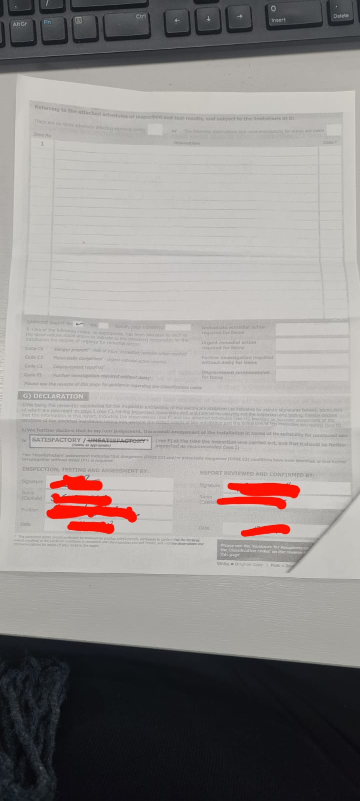

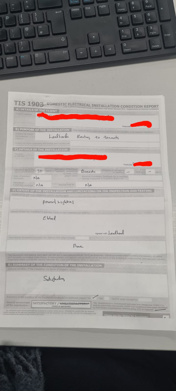

I have done many EICR tests with the latest legislation regarding rentals BUT I have had a few phone calls from estate agents/landlords asking me to look at a certificate they have...
Many a time they are 2/3 pages with next to no info
One just now is 2 pages with no schedule of inspections or schedule of results... looks like a waste of paper to me
Now I know I can't specifically do anything but my advise to the letting agent is to get it done properly because IMO that isn't a certificate and with them being responsible they need to cover their behinds
Am I right in saying this? I'm sure the blank certificates in the regs are the minimum information required on a certificate
Ill add photos. I hope it works (there's should be 2 attached)20210126_140713.jpg

what is that under agreed limitations “Ebbal”. .?
When I first looked I thought it said EBADS not sure but firstly it's in the wrong section and secondly its now ADS. These EICRs are just getting worse they used to at least look like someone had actually been to site wrote the DB schedule and then made up the results, now they look like they been wrote out by someone who does not have the first clue about electrics .
At some point some tennnant somewhere will be killed because of an electrical fault. The court will look into things and the satisfactory EICR will be shown by the landlord/agent. An expert witness will be called who will rip the said EICR to pieces, and the 'electrician' who produced it will end up in prison.
Only a matter of time, but it will happen somewhere.
Not quite sure but it was agreed with the landlord ?
Thanks everyone I was 99.99999% sure I was right in telling the agent that it was invalid. He is actually in agreement with me. Just another landlord trying to cut corners to penny pinch
May be a landlord who isn't fully aware of what constitutes an EICR. If an electrician hands him a completed report, he should be able to trust that it is suitable.
EICRs run to 4 or 5 pages or more and every little tick box must have something in it, (even if it’s N/A)
There sometimes even a page number at the bottom to tell you how many pages there’s should be.
Those examples are just plain lazy.
The best I had was an ETCI Periodic Inspection Report from a letting agent for a BS7671 installation. It erroneously declared that aspects of ET101 had been complied with which weren't applicable to BS7671. I doubt anyone had attended the property. I inspected it "again".

If you think the judge will accept that and absolve you of your responsibilities as an electrician then you are very optimistic!!
What’s he done wrong. Seen to many with” lim and N/“
As @DPG points out, a judge at some fatal accident inquiry would expect them to be able to justify their report and that it was in line with accepted professional "best practice".
Having agreed limitations on the report is fine if they are "reasonable", that is aspects that most professionals would agree are not practical to inspect and that there were no reasons to expect them to present a danger at the time.
To simply not do any testing, or to have omitted the results, falls very short of professional standards and the requirements for inspection and test in the regs.
