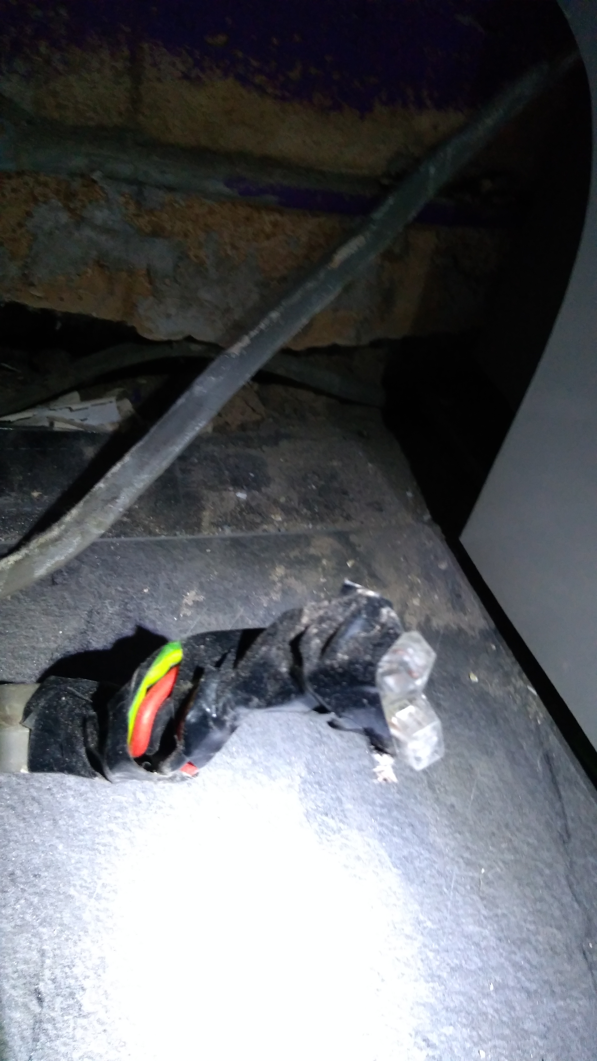

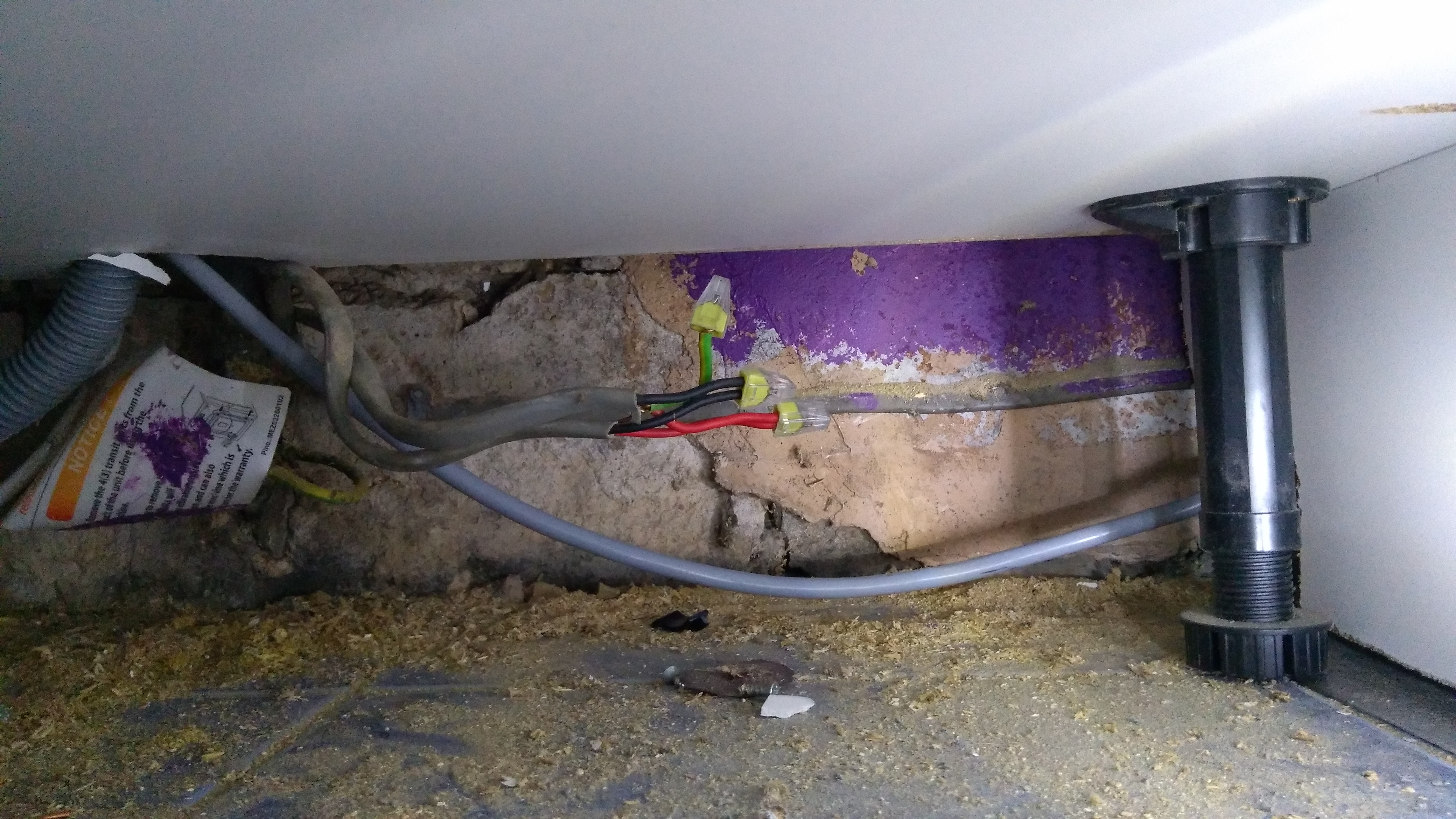

I have had a kitchen installed by a company and they have disconnected a couple of old sockets near to my sink unit. I have looked behind my tumble dryer and found the attached pictures of wiring left on the floor next to and under the sink unit. Are these safe to be left like this in a potentially wet area? They do seem to have caps on, but not sure if they are waterproof. Any help would be appreciated.

I found the second picture behind the tumble dryer, when I had to clean up some water that my grandson had spilled on the floor by the dryer on boxing Day. I then remembered that there used to be another socket for my old dishwasher in the previous kitchen, so today I removed the kick board under the sink and found the other wire lying there. That's when I posted the question, as it looks dangerous to me.
Wagos alone do not make a perfect job...but I am in no doubt that it is seen as totally professional by a kitchen fitter, who probably tells his mates "See, bludi electricians charge a fortune for that stuff, the cowboys!" in a smug manner...
Other clues: 1. Didn't bother to plaster, 2. Didn't bother to clean the sawdust away, 3. Couldn't even be bothered to wrap the wires completely in pic 2...

Also don't think twist on connectors have been used, both pictures look like Wago's, the 2nd one is just a real bad mess of someone trying (and failing) at taping up the cable
looking at OP's 1st pic. the muppets have actually twisted 2 cpc's and bodged them into 1 hole of the wago.

I sent a strongly worded email to the Installation company on Monday, and today had a qualified electrician come out to fix all the issues. After he had stopped swearing about how it had been left on the floor under a sink unit, he then proceeded to put the connections into boxes and removed any cables that were surplus to requirements.
I feel a lot safer now.
