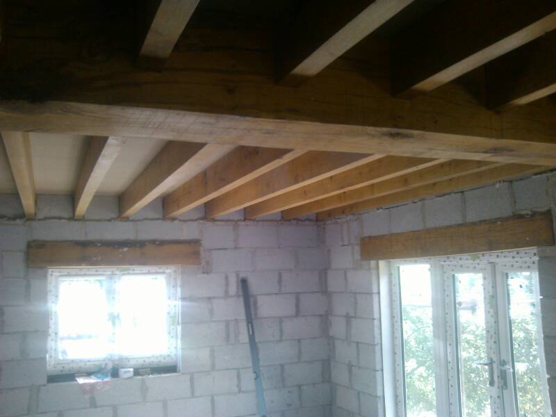

Hi extension kitchen with exposed beams. Walls to be dot and dabbed. Requested not to drill joists. in theory the bottom of exposed joists would be where plasterboard goes. So the 150 mm safe zone can be taken from the bottom of the joists? If so the cables can be run in oval against wall just below joists and drop down to sockets? I think so? Maybe im wrong lol. :eek:
They are to be on show. They are oak joists. In theory plasterboard would have been attached to them but in this case it will be recessed. This is why I said would safe zone be from bottom of joist?
So safe zone has to to be measured from recess of plasterboard?

looks like you'll have to drop cables in the safe zones in the corners, then horizontal to the accessories.
This is where you have to have a sensible discussion with the architect and client, with a bit of practice you will learn to steer them in the direction of making a sensible alteration to the plan.
I have been faced with near enough the same problem with exposed beams in the past, I have used two different solutions to it in different cases.
1 - have the infills between the joist battened down to create a small void above and notch the joists. steel plates can then be fitted over the notches to protect the cables.
2 - have a boxing made of the same wood and height as the main beam which fits against the wall covering the ends of the joists and looks like another beam sitting on top of the wall and holding the ends of the joists. This 'false beam' will look like part of the structure and give you a nice void to hide your cables in.
To encourge architects and clients the phrase 'this would add to the aesthetic' can be quite useful!

The safe zone is defined as "within 150mm of the top of the wall or partition" so I guess it's whereever you think the top of the wall is. I'd go for the bottom of the floor joists as this would normally be considered the top of the wall if a ceiling were fitted, and you've got to run the cables somewhere. That's just what I think though, I could be wrong.

Talk to the powers that be and get a sensible cable route established, or take them all through the floor and bring them up the walls instead of down.

Agree totally with what you say Dave. If some one designs a room with no thought for cable runs then that's pure daft.in this case this in effect what they have done. Concrete floor which is to be tiled, a ceiling with no practicle way to run cables.
There will be a small void with plasterboard recess, I will just have to push to drill the floor joists to use this option.

However you interpret the BS7671 requirements of the safe zones, and whether that means below the exposed woodwork, you are entitled to vary what you do as long as you do not reduce the safety margin and can justify what you've done. Talk to the other trades involved, make sure everyone knows what's going where, and make sure it's prominently documented on the paperwork left with the customer.
