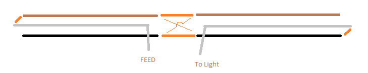

Yup,So instead of joining the 3rd cores together at the inter, feed in joined to go to common one of the 2 way switches, light feed joined to go off to common on the other 2 way, strappers as per usual on the inter.
Ha! Someone may explain it better or if you're lucky, draw a pretty picture!
So using your colours of choice:
L1 brown, l2 grey black common at the 2 ways
At the intermediate: brown and greys into L1 and L2 as normal.
Join one black to permanent live in
Join others black to switched live to light

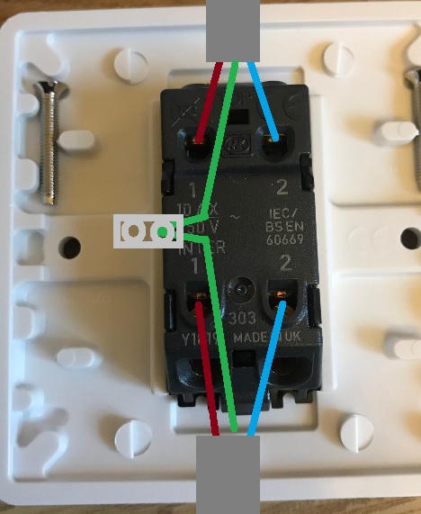

Don't know if this helps. Orange is a switch.
Middle one is intermediate, either as shown, or crossed over.

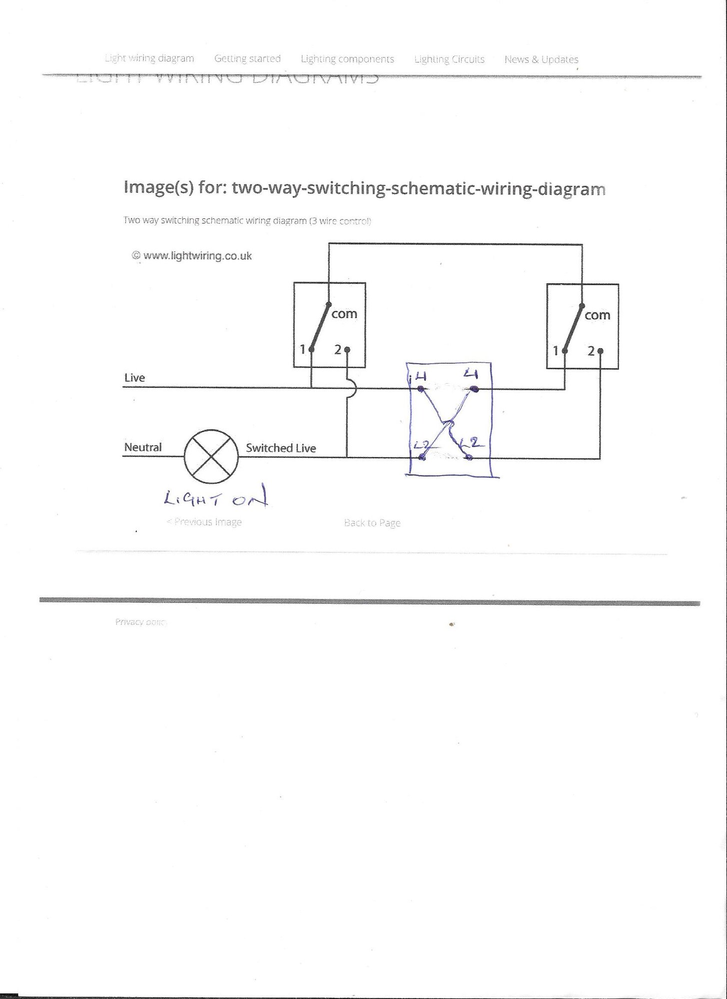

I suppose the easiest way of thinking about it is to take the normal basic 2 way switch setup with 2 strappers between L1 to L1 and L2 to L2. Then the feed to the common on one switch, and the load from the common on the other switch.
All you are doing is extending each common to the middle using the 3rd core.
The intermediate switch is just swapping the two strappers over and could be at any point on the circuit, or not be there at all.

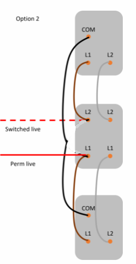

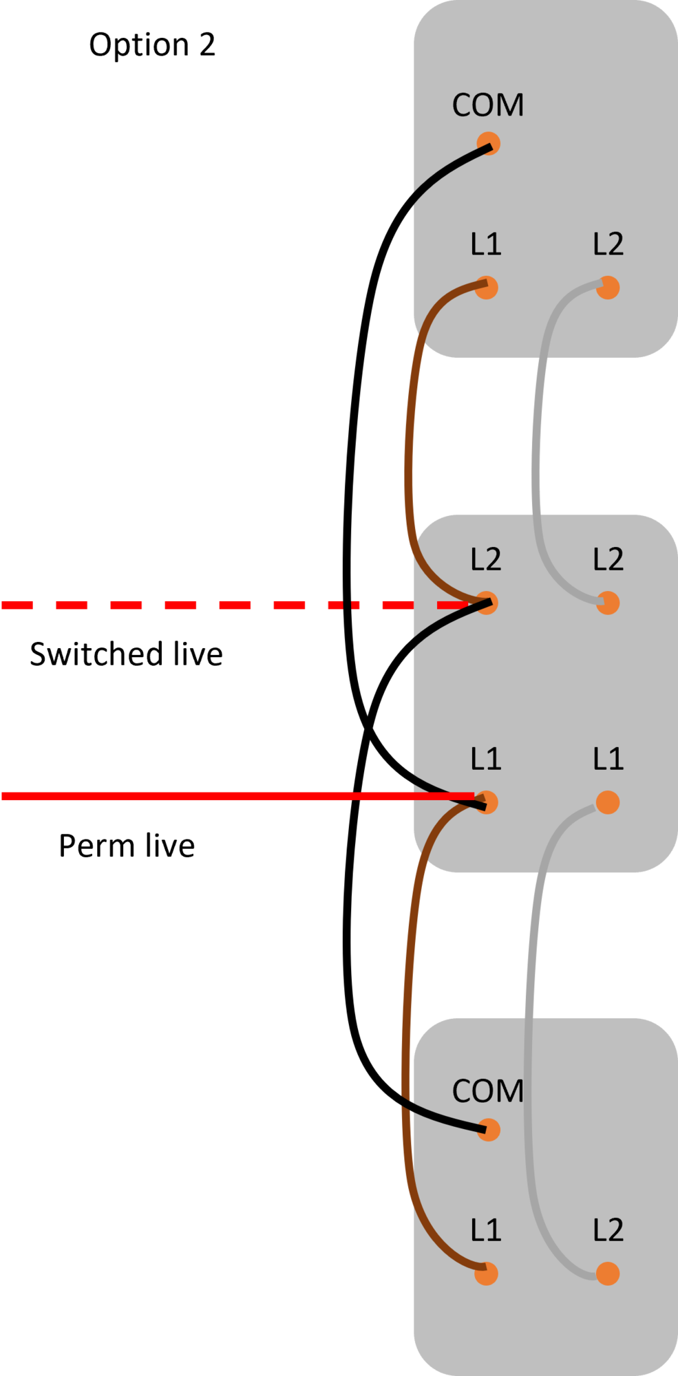

Had to read this thread a few times, but I think I got it.
So my understanding is that these are the two options described above - please correct me if I am wrong (and forgive my crude PowerPoint drawings)
Feed and switch wire at an intermediate... opt1 - EletriciansForums.net
and
Feed and switch wire at an intermediate... opt2 - EletriciansForums.net
It's still wrong. PL and SL must tap into the brown and grey of the same strapper cable. Imagine they were paralelled at one of the 2-ways, and then just transferred to the other end of the same strapper cable.
Yes. I think manufacturers are inconsistent with labelleling L1 and L2 on intermediates. Traditionally I recall it being L1 for both 'brown' terminals and L2 for both 'grey', but have seen drawings as per yours with L1 for both terminals facing one 2-way and L2 for both facing the other. Perhaps someone could confirm? I don't usually install light switches so it's ages sinnce I looked at one.
