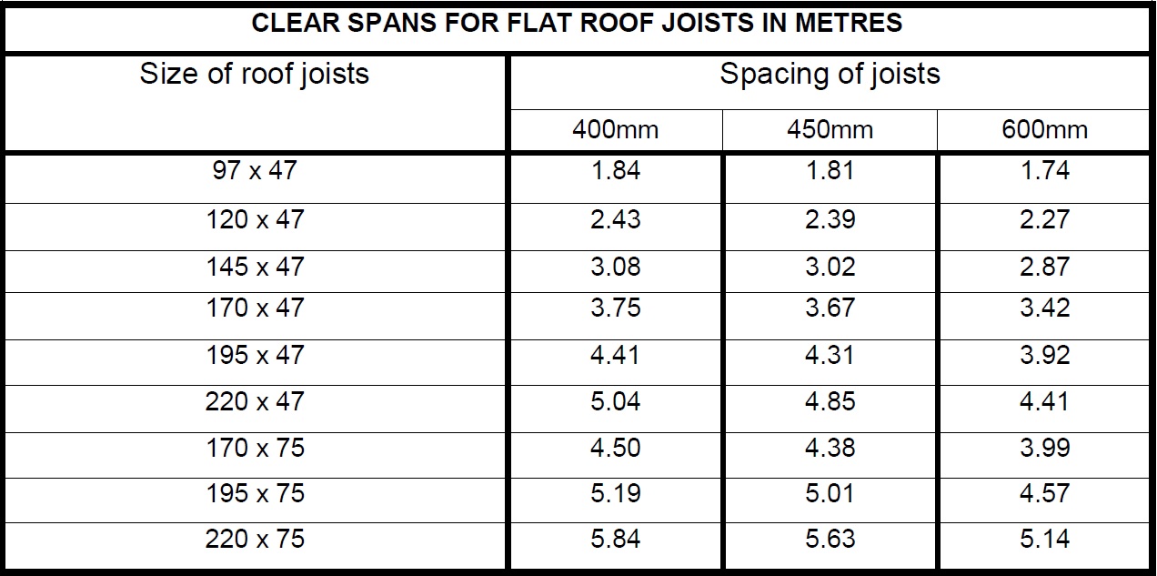

I think they have been over-sized
Check your span and centre to centre spacing against this table...
(taken from "Building Control Guidance Note, Subject: CEILINGS AND FLAT ROOFS, Timber sizes and construction details")
...to check if they actually are oversized first. (i'm guessing not, now, unfortunately for you.)
Knock up some wood dowels and hammer into holes with some PU wood adhesive let dry and trim off ends, then as sparky chick said glue and screw 18mm ply either side of the joist 500-600mm past the holes if possible,should be more than adequate for a flat roof
You're right, I've just checked. It's on the edge.
But I'm happy with the solutions suggested here.
