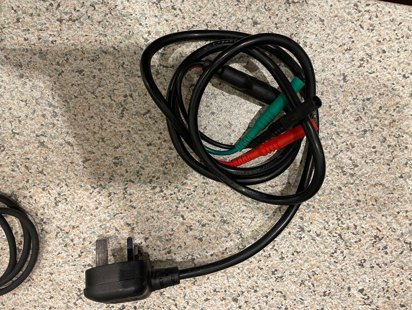

I can put some pictures up. It’s all working but the only setting it doesn’t do is phase rotation or RCD testing

If the RCD test setting doesn't work then it is not all working!
If that is the case then the decision is quite simple, it's broken, don't buy it.
If that’s what he meant, I completely agree.
I wasn’t sure if he thought the functions were not present.
The RCD circuit is shared by the No-trip loop circuit so a fault may show up there too.
