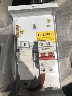

Hi all.
I’m a qualified electrician but haven’t had loads of experience doing domestic work so need some advice please.
The current consumer unit has no spare ways and she doesn’t want it upgraded.
I was going to install a 5 Way Henley block with 16mm tails for my new supply. I’m hearing different things on what to install. Originally I was going to put a DP Wylex Isolator in and run my 6mm 3 core SWA from that to a new Garage board, which will have an RCD and a 32a MCB and a 6a MCB.
However the wholesalers have sent me a 100 Fuse Switch. (Image attached) My friends at work have said this will be fine. But other people have told me that I need an RCD at both ends. So a Garage board with an RCD and 40a MCB at the meter end.
Also regarding the earths it’s a TNS system. The garage is only 15 metres away from the meter, can I just come off the existing MET for the garage earth. Or will a earth rod need to be installed.
Any advice will be much appreciated
Providence or order code mix up has substituted an isolator that gives no protection to your 6mm SWA with a switch fuse which can. You will need a smaller fuse than 100A I think to protect the SWA but it sounds good IMHO.

I would probably go for 40 amp BS88 at source in the switched fuse, this will give better discrimination in the event of a fault.

Yeah it has come with a 100A/80A/60A fuse. So depending on the main fuse I’ll put a lower one in to suit. Thanks xylophone

your SWA needs protecting with a 40A fuse in the isolator. it does not require RCD; as long as you ensure the armour is earthed at supply end. the armour may be used as cpc for the garage sub. no rod needed.

Although it doesn’t need an RCD in the garage. If I’ve got a garage board that’s got an RCD is it going to be detrimental putting it in?
you need RCD in garage board. it will be the only one on your installation.

Yeah ok I’m with you. Last question I promise, with the earth. I’ve got a 3 core SWA shall I just use the armouring as the earth and ditch the third core or should I use both? So when would an install require a rod, on a TNC-S system?
use both 3rd core and armour as cpc. then you still have cpc if steel rusts.. rod only needed if TNC-S and extraneous parts in garage, unless a 10mm bonding cable is added where the cpc is below that (allowing fot the steel as 8 times less conductive than copper ).

I’ve just looked and the lowest fuse with it is 63A. Should I get a 40A fuse or will the 63 be fine

not exactly. if extending TNC-S to an outbuilding with extraneous parts a 10mm bonding conductor is reqiured. the SWA may not be enough, so to save the expense of rumming in an extra boding cable, it's sometimes better to separate the earthing systems and TT the outbuilding.
