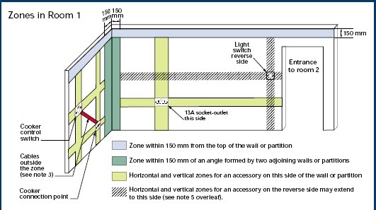

I am looking at getting my house rewired and want to check some information I have been given by one of the quoters. The house is built out of black blocks and has a solid floor downstairs. Currently the downstairs sockets are off the upstairs circuit and I want these separate, a new fuse board and kitchen circuit. The floor is up at the mo down stairs with no skirting board and the is a channel about 30mm square round the edge of the solid floor which also under cuts the wall. I wanted the downstairs ring ran in this to save on plastering and time (and the horrible black dust from the blocks being chased) and two guys have been fine with this, but the last one swears blind its not in the safe zone/ doesn't meet regs so can't be done. The channel is below floor level so the skirting isn't an issue. By the time the floors gone down i'd guess the cable would be 40-50mm below floor level and 10-20 mm back under the surface of the plaster.
Is he right or is he making work? The quotes are all pretty similar - until the third guy sticks in his 'making good' bits which also makes the job over budget (baby on the way so renovation budget is rather fixed), so its sort of make or break decision.

behind the skirting board would be a no-no, definitely not in safe zones. below floor surface sounds permissible , but , IMO, is a bit of as grey area. would it be feasible to use steel conduit in these channels?
Gut feeling is that , there ought to be a reasonable solution to this. Because the channel undercuts the wall, then its not safe to put cables there but if the cable is actually below the wall in the channel , then its not a safe zone issue more of a protecting the cable for foreseable damage caused by whateever. Now if the cables can be laid below final floor level and only pop up vertically to the sockets and when the skirting is on there would be no reason for anybody to attack that part of the building say if they were putting carpet grippers down etc, then you are someway towards a solution.
I would go what you think is reasonable here, i would ask how you would cross a door opening e.g. and look at all the cable runs to ascertain if they are actually safe from being damaged in the future and make sure they are below floor level, if any are vulnerable then conduit of steel plate would be needed.

safezones.jpgAs you can see there is no mention in permitted cable areas below the skirting board.
The safe zones are defined in 522.6.101 (v) and below the skirting would not appear to fall into any of the areas so defined.
As i undertstand it safe zones refer to walls, if its above ceiling or below floor level its not relevant. I cannot make out whether the channel is just at wall level or below floor as well, i'm sure the successfull sparky will sort it

think about it like this....when running cables under wooden floors (through joists and the like)...you would set those cables at a depth if at least 50mm....so whats different here?....whatever gets put down over those cables ...be it either wooden or laminate flooring certainly is not adequate protection against mechanical damage....run em in some conduit dropped into that trench....
