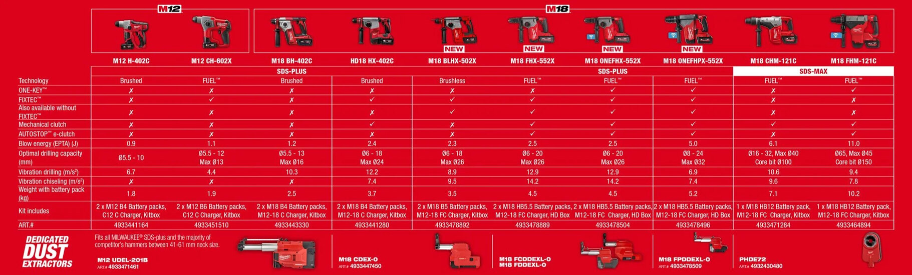

Good morning I'm after a new battery operated SDS drill.
I currently have a Bosch SDS hammer drill 240v that I bought 10-15 years ago for home use, however after being in Electrical vehicle engineering, I'm now doing L3 Electrical Installation and realised I'm going to need a battery SDS. I already have Milwaukee 18v and 12v battery system so was thinking it would be better for a Milwaukee SDS, but which one is the question. The price isn't an issue, but I have no clue if I should be looking at more impact joules of faster chiselling speed. I've added the Milwaukee chart to help. If you asked me about lathe or milling of metal I'm your expert but not SDS drilling and chasing.

Ideally at the moment I want to buy just one SDS which I think rules out the M12 platform and also the M18 BH from what you are saying. I will probably use it for some chasing (but if I end up doing lot of chasing in the future, I will probably end up getting a wall chaser). The main two I am looking at are the M18 ONEFHX and the M18 ONEFHPX, it will be used for drilling into brick and concrete, as well as chasing plaster and brick. As well as training to be an Electrician I own a few older properties I rent out and hope to renovate in the future. If in the future I do become a fulltime electrician I want to become a Commercial and Industrial sparky as I prefer the technical and complex work.
I have the smallest 12v which is good for rawlplugs and use single handed. I also have the ONEFHX which is very good and also the ONEFHPX which is heavy and eats batteries ( you need the 12AH) but has a lot of whack

Yet another vote for the biggest and the littlest. I use the big SDS solely for chasing (you still need it if you have a chaser as it doesn't get right to the ceilings, and if you're having to chase neat boxes a multi-tool and SDS is the combo, not chaser). Having said that for pretty much everything else; fixing boxes, capping, clipping SWA, NY, EV cable etc. I use the M12 fuel sds. It is an absolute winner. It's not just a weight thing, but compact-ness when atop steps with clips, hammer, screws, plugs and an impact, or nipping about from point to point, just much less to carry. The slightly less vicious hammer is also a bit better at not blowing bricks to bits. I've drilled 20mm through cavity walls with the M12, so it doesn't lack in power.
