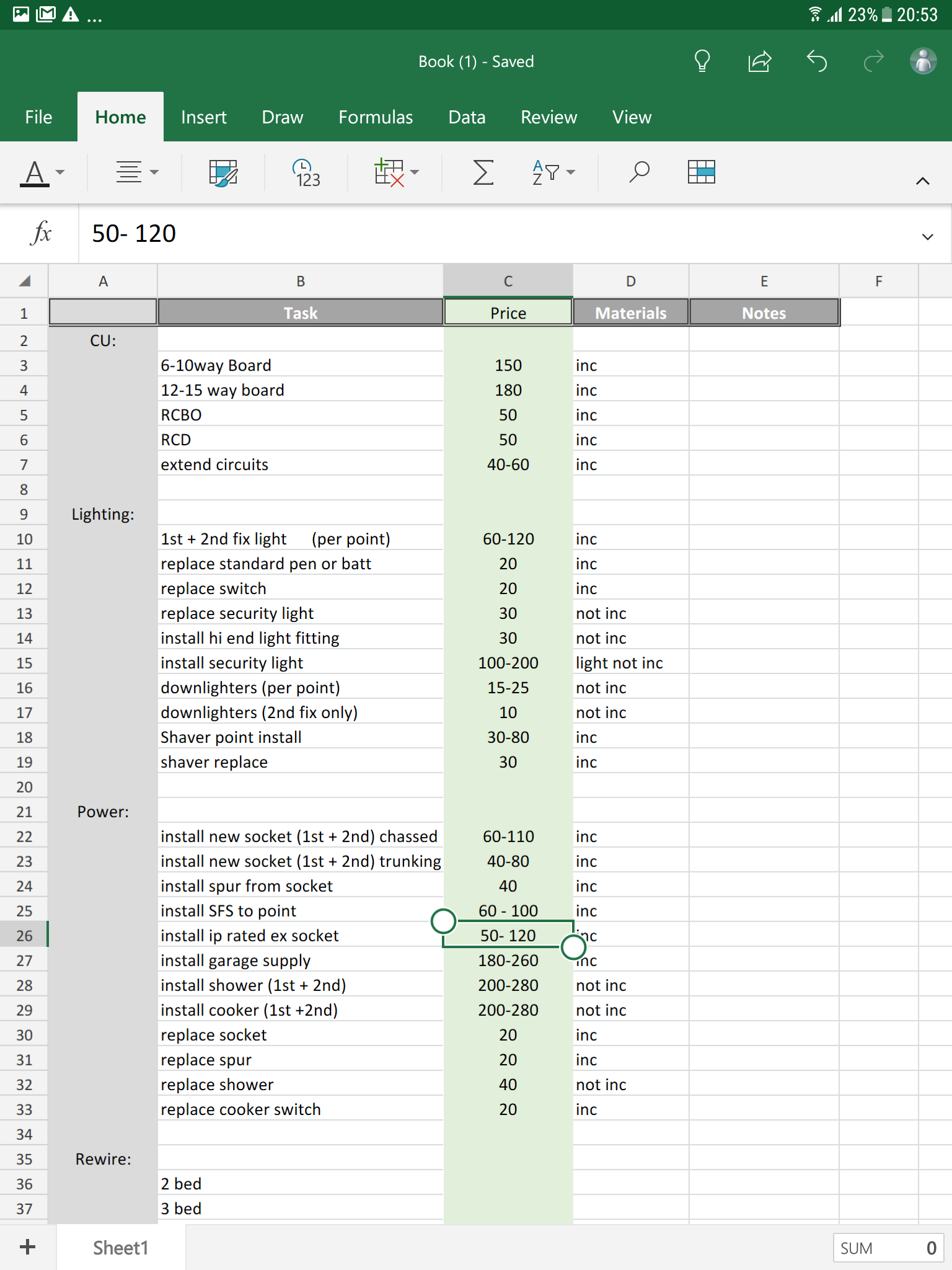

I've been a spark for 12 years now doing domestic and new builds but have recently decided to go it alone.. so far I've been able to price my jobs on a day rate but now I'm in the process of getting a small contract with a property developer and he wants to be invoiced on job price..
I haven't a clue how to price works ie: (1st + 2nd fix light per room - relocating socket - 1st and 2nd fix shower etc etc

Ive added a file..This is where I'm at.. starting to think I'm under pricing..

that looks in the right ball park, but for some of those prices, e.g. garage supply, you can't give a fixed price before seeing the job and sussing out the cost and time.
for easch job. i'dalsoestimate the time @ your hourly rate (£25?) and add materials + 20% and see if the figures compare with ytour price per point method.then on either quote, add 10 -20% to allow for wriggle room and the odd extra.
Your ggoing to travel to a job... Replace a socket, drive home and only charge £20 including the socket?
And whats that about a 10way ccu change for £150 including the board?
don't forget, he's pricing for new build so the CU is part of a complete installation. he's still too cheap though.
All new build ? Half the list is pricing replacements ?
maybe i misread. he said it was with a property developer. think now some will be new build and some modding existing.

Try and simplify them too, you have multiple prices for many different lighting jobs which appears confusing.
I try and work on a price for a point, first and second fixed, including basic white plastic accessory. Any other fittings or accessories are extra.
e.g lighting point including pedant/batten holder = £
Socket outlet including white plastic socket = £
If doing repairs/replacements make sure you have a minimum charge to prevent the £20 door to door socket job Suffolkspark mentioned.

on the "rewplace light/socket etc. prices. if it's a one off, allow £40 for attending, then hourly rate thereafter. no use going out for 2 hours and drawing £20.

I never worked like that on small jobs. I worked in labour and materials only.
For example
I day first fix for a pair= £450 plus VAT
1 day second fix for a pair= £450 plus VAT
I day finals and testing for a pair = £450 plus VAT
Materials = £400
profit on materials £60
Mainenance for year £100
total cost = £1,960 Plus vat to be added at 20%
