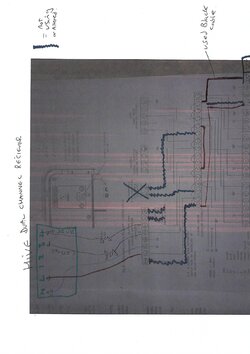

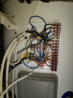

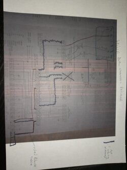

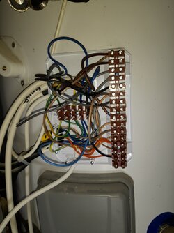

hi need help with wiring this.
basically new build with combi boiler, unvented cylinder with dual channel hive
ive attached pics with the wiring diagram giving but im now using a hive instead
so ive altered it to what i think is correct
obviously ive never sleeved any or added earths in diagram as shown

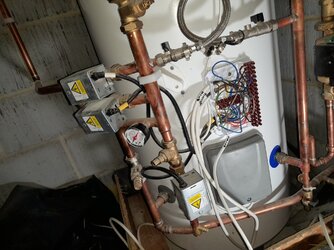

the kit come pre wired with 2 zone valves and thats the way plumber has left it, so ive doubled zone 1 and 2 up in wiring centre with link from 12 to 6.
ive ran a 4core n earth to boiler from wiring centre. but only connected brown, blue, black to switch live out.
is this correct as ive alter the diagram as it was shown live from 15 to boiler, so i changed it and went from 1 to live in boiler to give it perm live.???

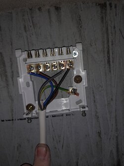

i also ran a 4core n earth to hive reciever into live,neutral, 3 and 4.

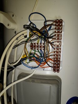

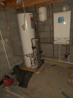

Something is very wrong there!
A combi boiler and an unvented cylinder just don't go together for a start.
What is the point of the unvented cylinder in this arrangement?
The plumber has joined the outgoing side of both valves together which is wrong.
You have bare copper links between the terminals of the joint box, they need to be insulated links.
With the number of pipes to the boiler it would suggest you have a system boiler and not a combi, also there would be no point in having an unvented cylinder with a combi
As per the clearly written warning label on the boiler terminals the supply to the external controls must be taken from terminal 2 and the switched live to the boiler connect to terminal 1.
The plumber has joined the outgoing side of both valves together which is wrong. One of those valves must be connected to the coil of the unvented cylinder.
sorry its a system boiler,

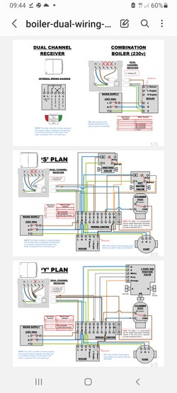

so why does this diagram only show 1 cable from outgoing side of boiler, do i need to use the grey aswell?

I would guess it is because that diagram is not supplied by the boiler manufacturer.
It looks like that diagram has been drawn by someone who doesn't understand what they are doing, where is it from?

off a website.

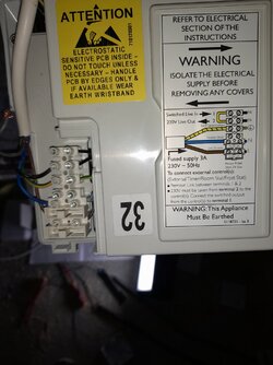

If it is from a random website and not from the boiler manufacturer then of course it isn't going to be correct for the specific boiler you are wiring.
It isn't even correct for the setup it shows.
The boiler needs a permanent supply, usually from a switched fused spur with a 3A fuse.
The boiler needs a signal from the external controls, this must be connected between terminals 1 and 2.
Terminal 2 is a 230V outgoing supply from the boiler to the external controls, terminal 1 is for a 230V switched live from the external controls.
The switched live at terminal 1 must come from the supply from terminal 2, this ensures that if the boilers internal fuse operates it cuts power to all parts of the boiler.
You can either connect terminals 1 and 2 to a volt-free output from the external controls or you can use terminal 2 to supply power to all of the external controls.

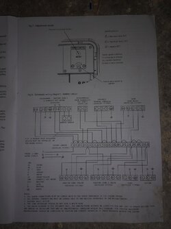

so this is the maual with the unvented cylinder.
is shows terminal 15 to boiler,, to me thats not a permanent live.
so basically all i want to do is get rid of the controls they sent me and fit a dual channel hive.
can you alter the wiring and show me please

No, terminal 15 in that diagram is not a permanent live, it is a switched live to the boiler.
But note 3 of that diagram says quite clearly that this diagram is for a basic boiler, you do not have a basic boiler, you have a system boiler.

As I have said already terminal 15 is a switched live to the boiler.
That diagram is not crap, it clearly shows how the system should be connected if it is being installed in the way the manufacturer has designed it to be installed. And shows how it would connect to the basic version of the components which are not supplied by the manufacturer.
The electrician connecting the controls is expected to have the knowledge and skills to read that diagram, and the relevant diagrams for the boiler and anything else and use that information to connect the system up in a way that satisfies the requirements of all the parts of the system and current legislation.
yes but the diagram doesnt show the perm liveinto the boiler at all.
so they wire my diagram is would it work or not? the one ive altered.
so if this was you doing this job how would you alter it to make it work on a hive setup?
I'd remove the connector strips from that terminal box and connect it up as a standard S plan system using wago connectors.
I'd probably feed the boiler directly from the sfcu and take a 4 core flex (L, N, S/L and E) from the boiler to the terminal box using terminal 2 to feed the external controls.
No it doesnt show a permanent live because a basic boiler doesn't require a permanent live.
You have a boiler which does require a permanent live and additionally requires that the external controls be fed from terminal 2.
If you have connected it exactly as per your altered diagram then the valves will open and the pump will spin, the boiler will not fire.
Additionally the boiler manufacturer will not support any warranty claim and their service technicians will likely refuse to work on the boiler due to it not being connected as per their requirements.

i thought the brown in the zone valves where perm lives but looks as if its the grey wires thats perm lives.
its just a head scratcher for me this one its been 15 year since i done this setup but without using a hive.
Brown and blue are the motor, grey and orange are the microswitch.

Not sure why this should be a such head scrataher when you can pick virtually any "S" plan diagram and substitute the the dual channel programmer with the dual channel hive

There is more than one way of connecting this system but the following will work.
Run 3 core flex from switchfuse to boiler.
Connect the brown to L, the blue to N and the earth to earth.
Do not connect anything else to the supply from the switchfuse.
Using the 5 core flex you have already run from boiler to terminal box.
Connect blue to N and earth to earth at both ends.
Connect brown to boiler terminal 2 and the live supply of the controls terminal box.
Sleeve the black with brown sleeving at both ends, connect it to terminal 1 at the boiler and the boiler switched live at the controls terminal box.
Make the grey safe at both ends.

Terminal 2 from the boiler is the 230V feed out to the external controls. Terminal 2 supplies power to the external controls.
Terminal 1 at the boiler is the switch live in.
so what goes to 3 and 4 in the hive
As I have already said
The feed from the switchfuse goes to the boiler, only the boiler, nothing else.
this is last post im sick now, this has to be correct?
No you have terminal 2 on the boiler linked to terminal 1 in the wiring centre which is unnecessary
Yes it is, otherwise the wiring centre won't have a permanent live for the valves.
so if i just double up the zone valves 1 and 2 it will be ok, as im only using 1 zone, plumber must of just got the kit like this and left it like it is, or does it need changing
Given that the diagram still shows the live feed from the spur to terminal 1 of the wiring centre it isn't needed
In fact the boiler may be fed from terminals 1 & 2 in the wiring centre as in the diagram posted at #26 by the OP
No it can't, the instructions on the boiler clearly state that external controls must be fed from terminal 2 at the boiler.
