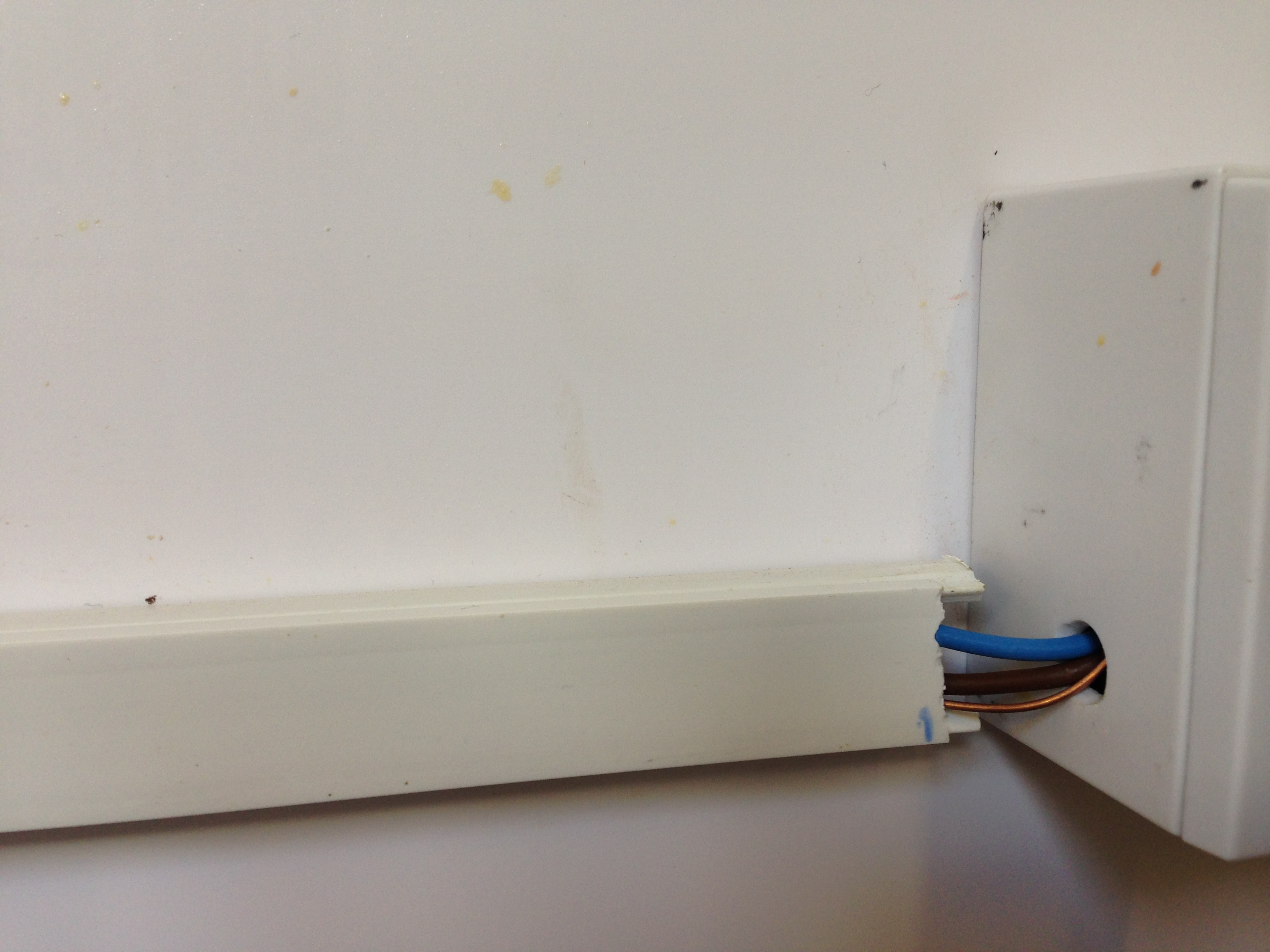

Was just looking for some best practices around using plastic mini trunking.
How do you guys join trunking on corners of walls that are not right angles so you can't use the normal pre made bends. I mean I've got a vertical wall and that has got a bend of about 30 degrees in in.
Every time I cut the bloody stuff I end up with a slight gap in the trunking which does not look great tbh. I was thinking of just using caulk or silicone filler but am seeing if there any tricks of the trade?

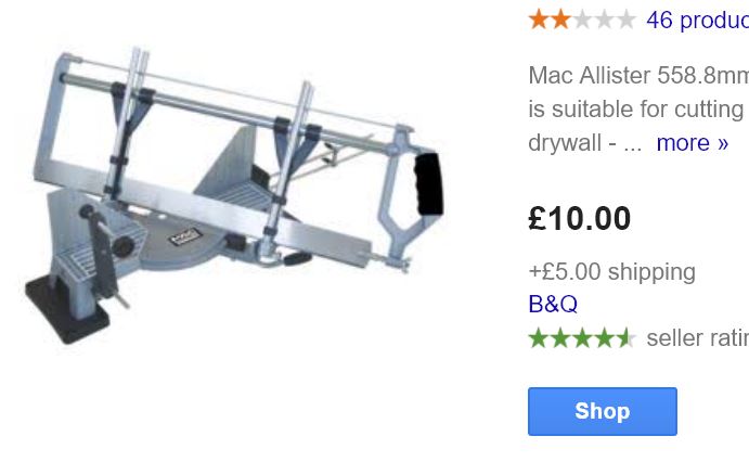

Angle gauge, steel rule, saw, file, knife. Apply tools to trunking in the manner prescribed by the art and craft, and a perfect joint results. There's no magic shortcut - electrical installation work is a craft and it requires skill and practice. A joiner can make joints in wood of arbitrary angles that fit together exactly and look smart; an electrician should be able to do the same with electrical materials. Unfotunately, the very kind of work that uses PVC mini trunking is not the kind to draw the attention of the most skilled craftsmen, so one doesn't see precision work in mini around the place.

You need the right mini trunking for a start.
Marshall Tufflex or similar with a lid that overlaps by several mm is useless for making neat mitres. The best trunking by far for forming angles is CEF Centaur because the lid is completely flat and fits securely.
I can form perfect angles and double sets with Centaur, no chance at all with Marshall Tufflex. All it takes is a little thought and practice.

i get a piece of scrap (cut off) trunking lid. cut a nick in the sides, bend to the angle of the wall/ceiling/whatever, then transfer to whatever i need to cut.
