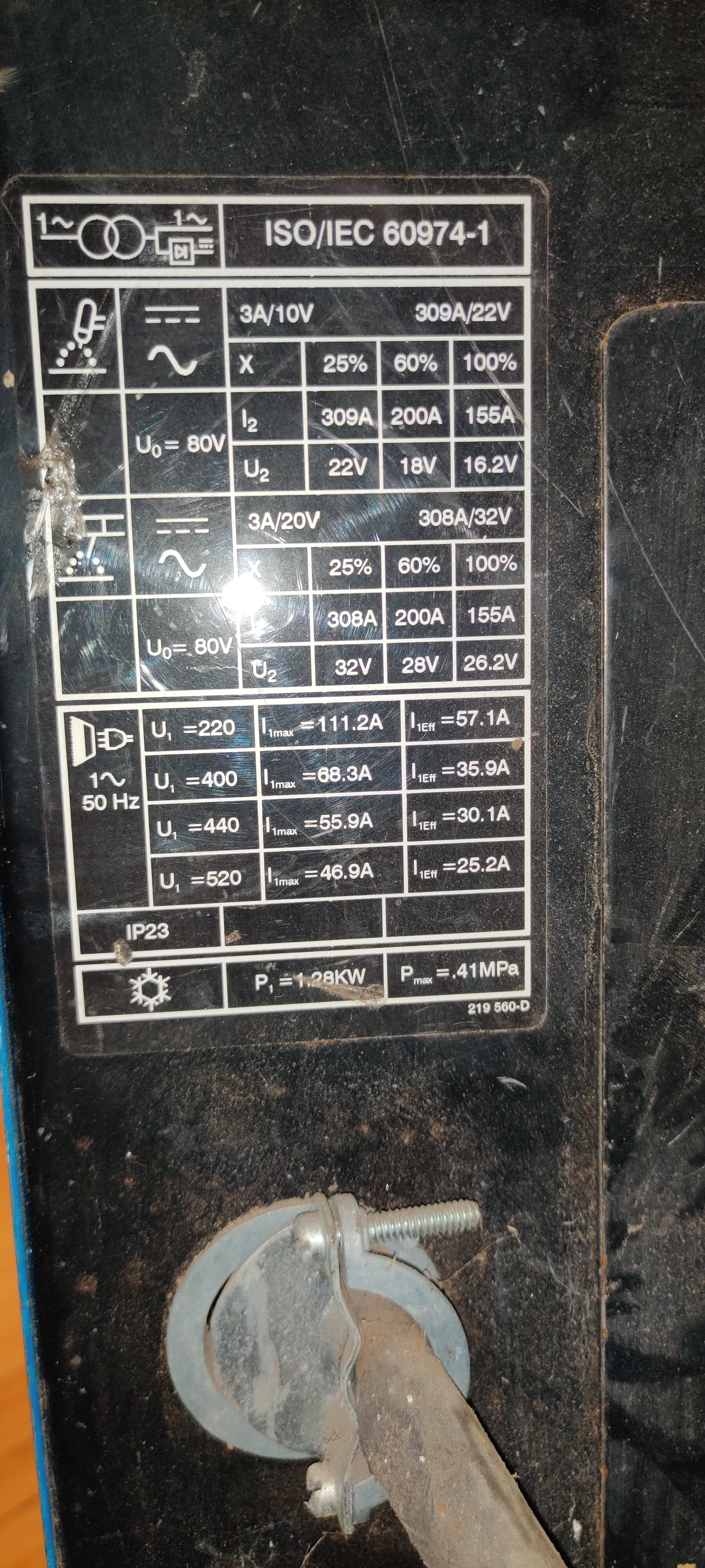

When I joined this forum a decade or so back, there was a discussion going on about a welder that was connected with a 3-core cable to L1, L2 and earth of a 3-phase supply, operating on the 400V present between L1 and L2. The advantage of choosing 400V is the reduced current requirement. My own portable stick welder has this option too with a voltage selector on the back. It will run on 16A if 400V is available, but 32A is needed if you switch it down to 230V.
According to the particiapnts in that discussion, the use of L1 and L2 made it a ‘2-phase welder’ because it was 'connected to two phases.'
'No,' I said:, 'it's single-phase' and was quickly admonished that I didn't know what I was talking about, and told to go and look up some definitions (that was the usual reaction back then to pretty much any newcomer.) I tried to make the distinction between various configurations:
a) A single phase device operating at the line-line voltage of a polyphase supply like this welder, using two line wires but no connection to the neutral.

As soon as we move from star-connected 230V windings to delta-connected 400V ones, things are a little more complex. Now, coil A is connected between L1 and L2, B between L2 and L3, C between L3 and L1. The load phases are no longer equivalent to the lines, but there are still three line wires, three coils, three phases. Moving now to the situation of the original welder and other single-phase 400V loads, UK electricians today are unfamiliar with connecting them between the lines. Looking back in time and across continents and oceans, this was not so unusual. e.g. aboard ship or in 1950s Europe. A 132/230V system with 132V present between line & neutral and 230V between lines has been widely used in the past. There, it would be perfectly normal to connect your 230V single-phase device across L1-L2, complete with double-pole switching and fusing, because that is how you get 230V from that system. That doesn't make the 230V load 'two-phase' any more than my single-phase portable welder turns into a 2-phase one when you flip the voltage selector.
Have you noticed what I haven't mentioned yet? Time. Phases are about time. In a 3-phase system, first one voltage peaks, then another peaks, then a third one peaks and we go back to the beginning. That is how a rotating magnetic field is produced inside a motor, how the neutral current sum to zero, how there are no power-zeroes etc. Phases of the moon, phases of the supply; it's a matter of things happening at different times. This is what the contributors to that old thread were not thinking about. If the welder only has one primary coil on its transformer, only one thing can happen at one time. To be '2-phase' it would need two primary coils, one coming to a voltage peak first, then the other one, then the first one again. Out of phase with each other. 100 years ago there were 2-phase motors which worked pretty well. They did have two coils just as a 3-phase motor has three. But ultimately the 3-phase system proved more versatile and the 2-phase was dropped. Americans / Hungarians, or Tesla / Westinghouse, if you want to look at it from a commercial angle.
