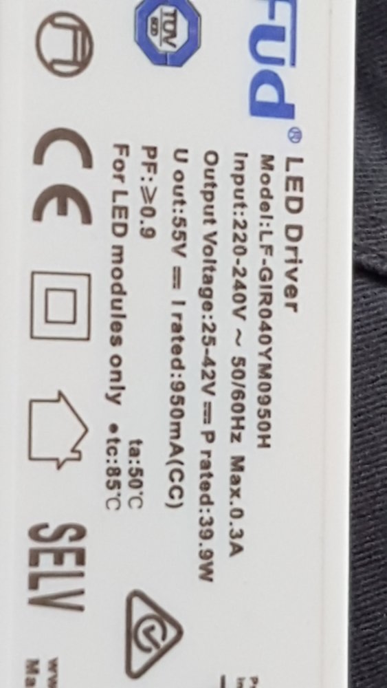

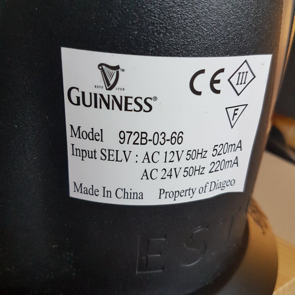

Hi, I am trying to make a feature lamp out of a Guinness LED beer front,20200423_182204.jpg20200425_135033.jpg I need to transform from 240v to either 12v 50Hz 520mA or 24v 50Hz 220mA (pic)
What transformer is needed?
I have a LED transformer that gives 25-42V (pic) is this to powerful?
Thanks in advance
The LED driver looks too high a voltage for the Guinness pump.
If you can get a 12V transformer, probably the sort used for pool or bathroom lighting, it should do as they have more than enough capacity. (If you wonder the SELV part stands for "separated [or safety] extra-low voltage" as not all transformers provide enough isolation, and to a power engineer anything below 1000V is "low voltage").
[automerge]1587822063[/automerge]
Something like this might work for you, it meets the 0.54A demand on the nameplate:
View: https://www.amazon.com/12V-AC-Adapter-Model-Transformer/dp/B07CS5SSG9/ref=sr_1_65?dchild=1&keywords=12v+transformer&qid=1587821955&sr=8-65
