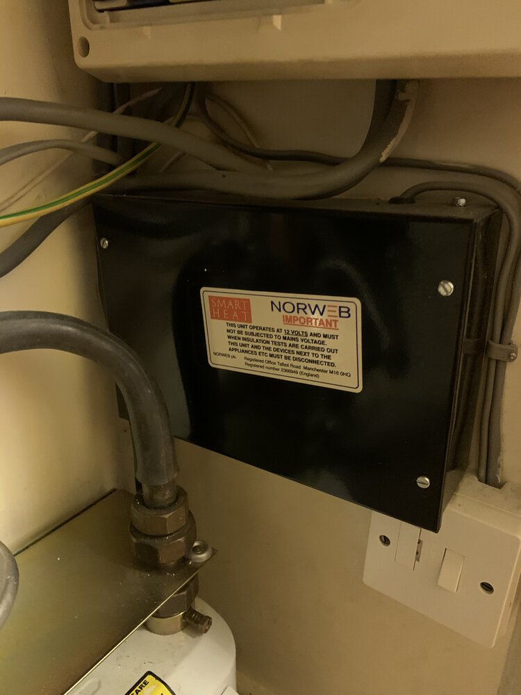

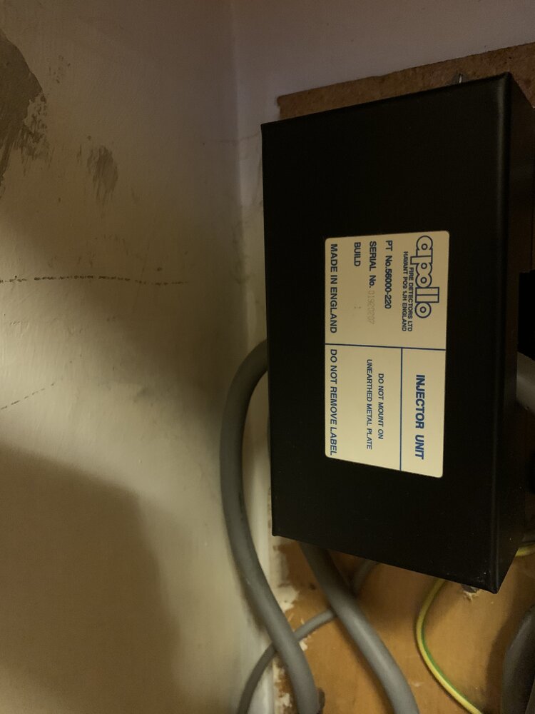

Hi, i have recently bought a a house and has the Norweb Smart Heat System installed with an Apollo Injector. Never seen this system before, i am wanting to strip all this out as i will be installing central heating but would like to know how it works and what it actually does.
Cheers
It's a centralised control system for multiple storage / panel heaters. The injector sends control signals from the central box to receivers at each heater via the power cables, avoiding the need for extra wiring.
