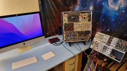

I am a musician and use a modular synth in two cases (powered by three uZeus power supplies), which runs into a Focusrite Scarlett sound card, then into an iMac, running the test OS. See attached photo.
I had to take my gear down while I did some work on my desk space. Having put it all back together I powered on my cases, and now my mac's cursor is acting like I am doing lots of right clicks. If I hover over a menu it starts spamming these phantom right clicks.
The uZeus power supplies are plugged into a different 6-way to the mac. This only happens when the eZeuses are on. The more of them I power on, the worse the issue becomes. Everything was fine for months before. I can't see anything I've changed.
Unplugging the Scarlett's USB power stops the issue. So does unplugging the 1/4" jacks from the front. But obviously these are not fixes.

USB devices are not normally particularly senstitive to power-derived interference e.g. from earth loops and DC offests created by multiple external power supplies. I build a lot of equipment of a similar nature (not synths but audio/video/computer workstations) and have never had a single problem of this nature, but dealing with interference in mixed analogue/digital systems is one of my specialities.
Presumably when only the second rack is on, it is still connected to the first rack so there is an unbroken ground loop from it to the iMac? Can you give the model and configuration of the eZeus power units - are you using the distribution bus boards?
Are the audio outputs from the rack to the Scarlett balanced? If so, it might be wise to lift the ground of the Scarlett interconnects, which I think will solve the problem. Obviously we should try to find the cause first, as it was not there before, but if the option is there to separate the analogue and digital grounds, that would be worthwhile anyway. If the output is not balanced but is reliably earth-referenced, it might be sufficient to connect the Scarlett input cold leg to the synth output ground, in place of the Scarlett ground.

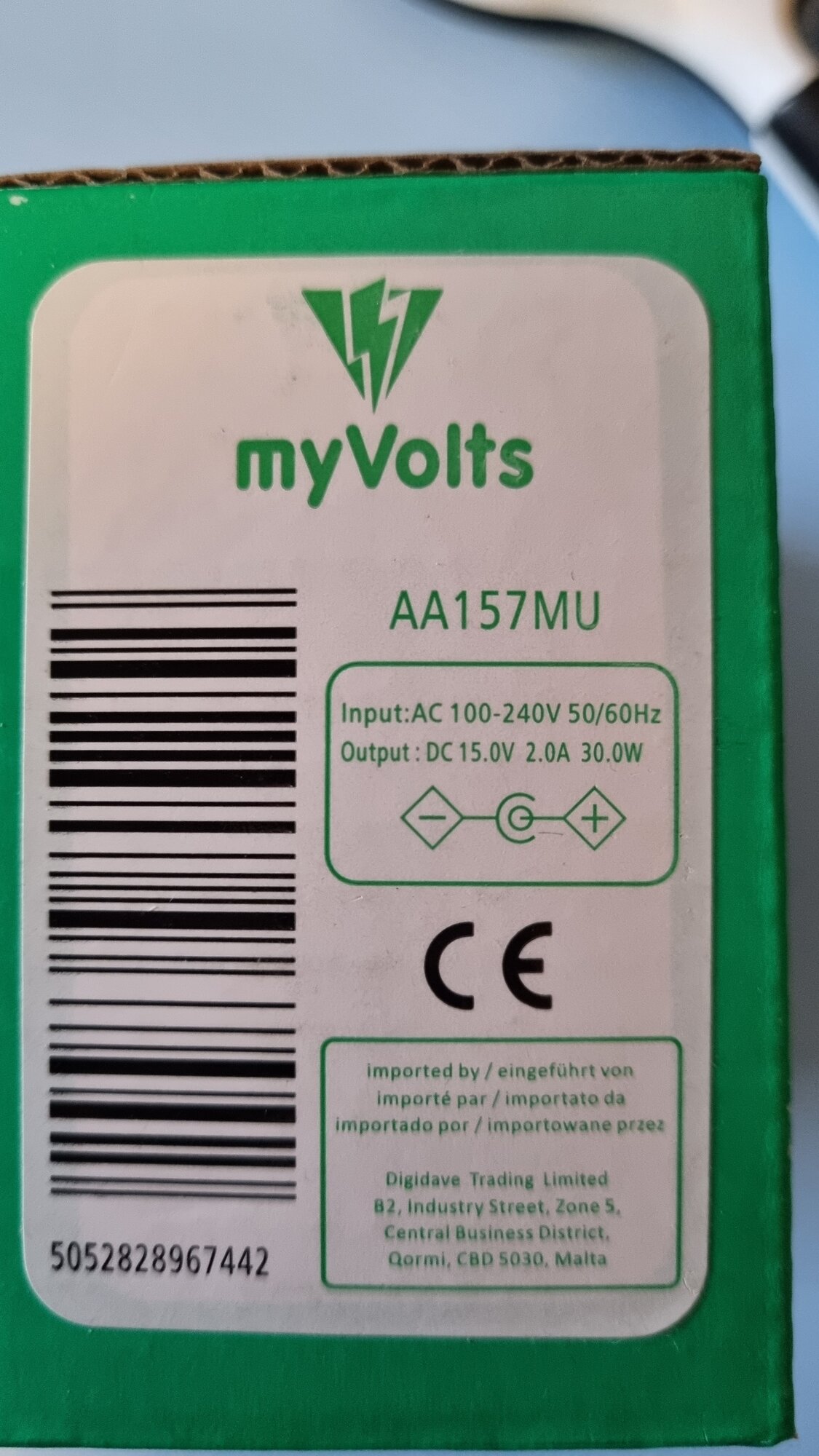

The TipTop uZeus module info is here: μZEUS - Tiptop Audio - https://tiptopaudio.com/uzeus/
It says: The μZEUS mixes linear and switching power technology that can produce up to 2000mA at +12V, 500mA at -12V, 170mA at +5V.
The power supply info is attached in the photo. The product data on the label will make more sense to you than me :)

To sum up: no matter which outlet the racks are plugged into, as soon as I connect everything together and into the iMac, the problem arises. But it also manifests when the Scarlett is plugged into the MBP, and nothing is plugged into the iMac. If I disconnect the Scarlett, the problem stops.

My current thinking is that one of the 15V adaptors has gone rogue and is outputting HF noise that happens to be at a frequency to which some relevant parts of the computers' I/O logic is susceptible. That would account for why rack 2 PSU can cause a problem even when islanded, but less severe when plugged into a different socket. When the system was out of action for a while, was this the first time the adaptors have been unplugged for a time? If so, or if there is some disturbance to their usual routine, this can trigger dormant problems in SMPSUs.
These power bricks appear to be regular switched-mode PSUs and could be replaced with any 15V supply >2A, although I appreciate if you don't have one lying about you've got to buy it whether it helps or not. Do they have a 2-pin or 3-pin mains inlet and cable? Relevant because we would need to consider the earth path when speccing a replacement.
I expect the uZeus module has a solid connection from its input negative to its output 0V / synth ground. If the bricks have a 3-pin inlet, there might be a path from mains earth to synth signal ground, depending on the internal construction. Some in that power range (30W) have no connection between inlet earth and DC output negative, some have a barrier resistor and some have a solid connection. You could check the resistance with with a multimeter with the PSU unplugged, measuring from the input earth pin to the barrel of the DC jack.
