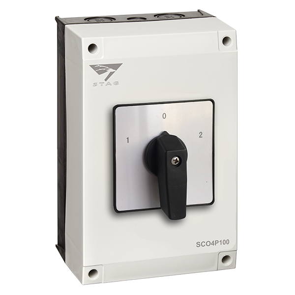

Below a sketch (if I dare call it that!) of how you might wire it with a two pole three position centre off switch, assuming making the battery -ve's common is valid, and won't adversely affect EM interference from motor to fish finder! You might find a EM filter would help that.
Otherwise, if you can't common the -ve's, put the same switch arrangement in the -ve side of the batteries as well. You would need a 4 pole version of the switch, but that shouldn't be a problem to find.
PS, Taking 35A from a 10Ah LiFePO4 battery won't do it much good long term, but presumably this is more an 'emergency' provision than for regular use 🤔
...if you can't common the -ve's, put the same switch arrangement in the -ve side of the batteries as well. You would need a 4 pole version of the switch, but that shouldn't be a problem to find.

Not quite. I'm suggesting that the battery terminals go only to the switch, and you arrange the contacts to take the appropriate battery polarity to the appropriate load. You won't need diodes if you do it this way.
I've drawn a two pole 3 position switch. Since it seems you need to switch the -ve's as well, you would need a 4 pole 3 position switch (as I've drawn but with switches added for the -ve terminals as well)
You can implement this with a 4 pole 2 way centre off switch, or a centre off cam switch with 8 sets of contacts. Are you happy to work out the logic of this?
As long as you route all battery connections only to the switch, and arrange that to feed each appropriate load wire for the switch position, you'll be fine.

Ok. These were my thoughts. Need checking through.
And to add an edit here - I had not appreciated your desire for different permutations of whar powers what. The following explanation doesn't do that.
But I think a switch with more positions might - I need to give it more thought!!
The first type of switch that came to mind was 4 pole centre off double throw, this sort of thing, but this is not high enough current:
Each battery would be wired to a pair of contacts in the middle, and the motor and accessories wired to the outer terminals, as illustrated in my diagram.
The more likely choice would be a rotary cam switch, with sets of changeover contacts, such as this:
Say 100Ah battery -ve to 2&4 batt +ve to 6&8,
10Ah battery -ve to 10&12, +ve to 14&16
Then for 'normal' operation, motor +ve to 1, motor -ve to 5, and accessories +ve to 9 and -ve to 13
And for 'reversed' operation, accessories +ve to 3, acc -ve to 7, and motor +ve to 11, -ve to 15
If the links for UK products don't work for you, please let me know.

This would do the battery changeover, you could use a pair of relays instead if dpdt aren't easy to get.
Same circuit again for whatever battery you want to run accessories.
You can hide the relays away and have a pair of small water-resistant switches remote from them.
