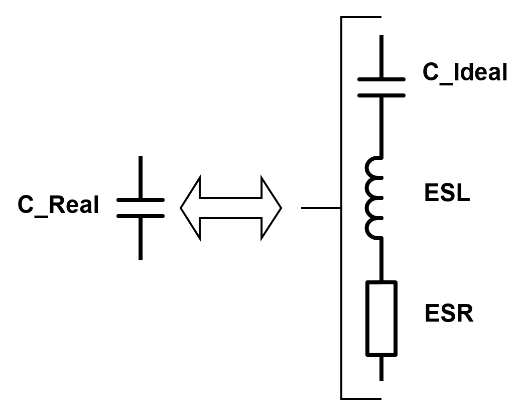

OK so what is the impedance of a 10μF capacitor?
The impedance would change depending on the signal Z = -j / (2πfC)
Reactions: davesparks
So the impedance is totally dependant on the signal applied to it?
There are additional secondary parameters inherent in any real physical capacitor, such as the internal reactance (Equivalent series resistance ESR, and equivalent series inductance ESL) which are also dependent on frequency, and, yes, the impedance will depend on the frequency you measure it at.
