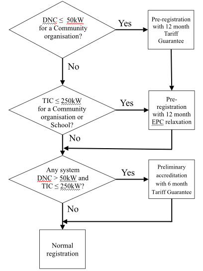

I think that there is still a bit of confusion around the differences between preliminary accreditation and pre-registration which the OFGEM guidance doesn't do much to sort out, especially with how they affect tariff guarantees and Eligibility Date.
Here's a stab at teasing out the meaning as it applies to PV:
Another gotcha worth noting is that any application for preliminary accreditation submitted to OFGEM between 1 January and 31 March will be given a tariff date of 1 April, which is not exactly a tariff guarantee at all.
