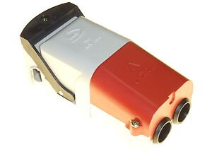

like this. cable into bottom, cable drop into top, or have i mis-read the post?

the posts are hollow underneath so that is no an option....there have been supplied terminal housings like the one post by another spark below like the one we have but they are no big enough for a 16mm2 cable ....
