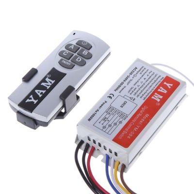

i use a remote receiver enclosed inside a IP65 ad. box. at home it'sa 3 channel, 1 for lights, 2 and 3 for water features. receivers come from China , cheap as chips. not had a failure in 10 years.
Ok, this would meet 18th regs?
lights on the fence plugged into a remote control socket that is plugged into the existing double socket.
a wise box for one circuit seems a bit to much. The remotes sockets are about £20 for 3.
those remote sockets are no good outside. they are not suitably IP rated and when plugged in you can't close the lid of your IP65 outside socket. this is similar to what i use:
Ok, I did think of that so I was going to House the ip65 socket inside a large weatherproof box for protection because I wouldn’t be able to close the lid.
I think your idea is a better option tho. Thanks
As above Quinetic Kinetic remote switches are the way to go, no battery to run out when you least expect it and the control unit is very small, just needs a waterproof box and wired to the lights, switch can be anywhere.
Looking at the quintec, I have two lighting circuits so i would need two controllers unless they supply one that can handle two separate circuits. I would also need two remotes.
the Knightsbridge remote controller is about £50 and can run 3 circuits,
