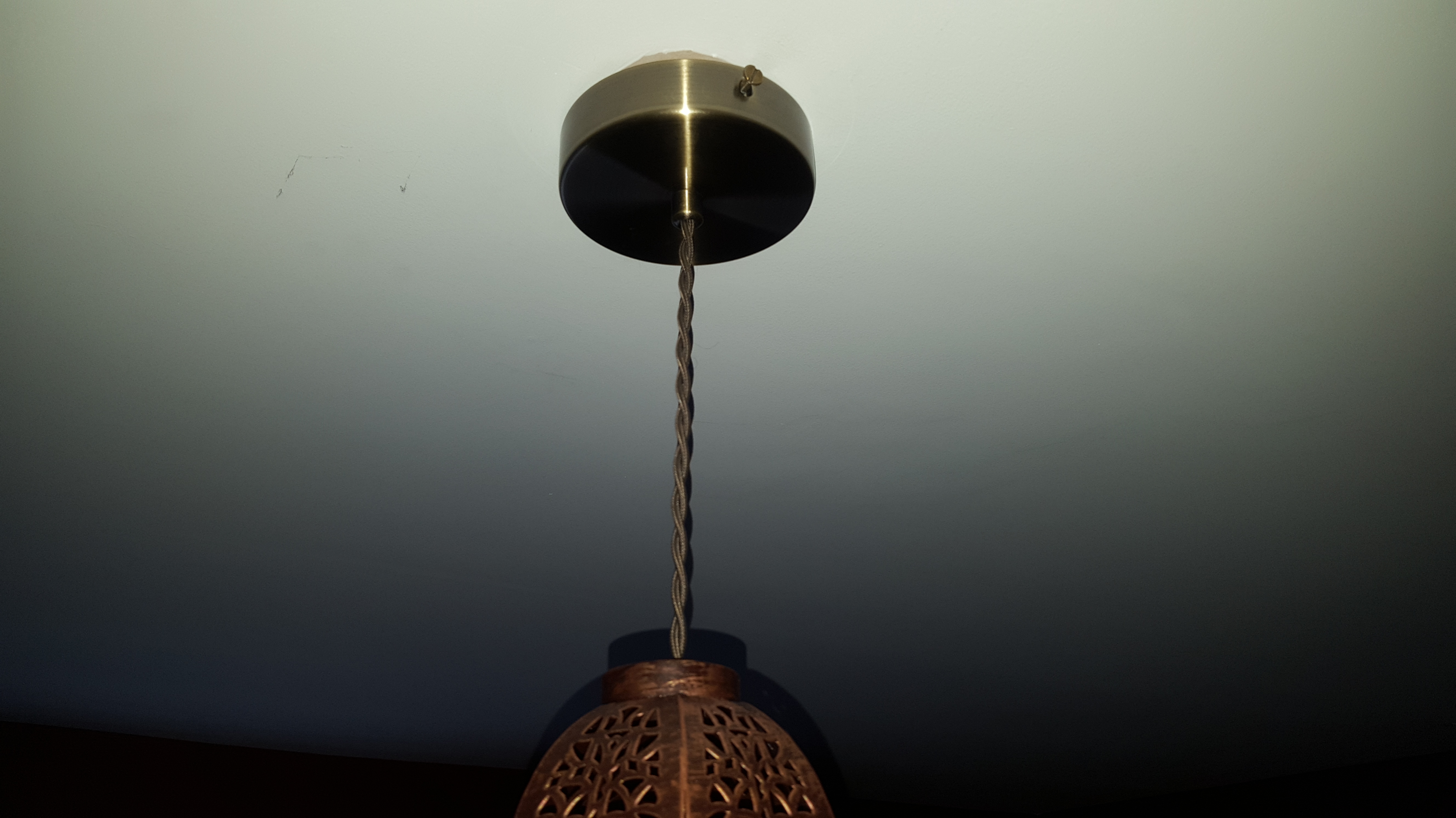

I'm a little perplexed by a simple light fitting replacement that has turned unexpectedly interesting.
Replacing the fitting I linked the loop to a junction block and sealed it with insulation tape (as the new fitting didn't have any connectors as standard. I connected the live and neutral as normal and as there was no earth on the metal light fitting I connected the earth to it (with a screw and washer, basic but serviceable).
Upon switching the lighting circuit back on the light comes on as expected but my pen mains voltage tester seems to think the metal casing is live.
I've crawled into the loft just to make sure I didn't screw into any cabling when re-mounting the fitting and that seems all fine.
Am I doing something incredibly stupid or does it appear that the earth for this loop is live somehow?
I am an amateur and so any help would be extremely gratefully received.

Was The "Earth" wire you connected, in use on the old fitting?
Have you got a picture of the new fitting, it would be unusual for a metal fitting Not to have an earth connection.?
If used to vehicle electronics you are bound to have a multimeter ... better to use that to test than a volt stick but still not ideal.
You haven't by any chance nipped a wire when you installed your earth point to the fitting? Where did you buy this fitting from?

If the metal light did not have an earth terminal then it may be a class II piece of equipment and would be marked with this symbol.
If this is the case then an earth is not required.
A voltage tester pen could well pick up the power cable as well as the casing.
You would need to do contact testing with a two pole voltage tester, but there are risks inherent in this if the casing is actually live.
Get access to test points whilst the power is completely off, preferably by switching off the main house switch, then test without exposing yourself to danger.

It is indeed a class II unit. It mentioned that in the instructions.
The fitting been classII would not require an earth, what makes me uneasy about this is the fact that the metal mounting bracket would not be affording double insulation against your connecting wirescoming through the ceiling, the fitting integral wiring will have 2 layers of insulation afforded to it thus not needed earthing but it depends if your fitting mounts to that ceiling bracket with plastic or metal - I see a poor designed fitting if this is the case and would leave the earth as you have done. Can you post a pic of the whole fitting.

Please see picture of external of light fitting. It does indeed connect directly to a metal external casing without any additional protection. This is the main reason I was concerned and attached the earth directly.
I was careful not to cut into the insulation of any of the wiring when replacing the fitting, though I absolutely accept it is possible to have done so without being aware of it.
Am I detecting that mains voltage testers are unreliable? Not a surprise at the price.

In my opinion the manufacturer has got it wrong which is scary, the top bracket and cup need earthing due to the single insulated joints it contains but as the copper/brass metal shade is classII insulated then no need to earth the shade.
Understood. I'll leave the earth in place then, be even more suspicious of cheap light fittings in future, lol, and dig out my multi-meter to double check the cup and bracket as it's almost certain the pen is giving me a false reading?
The earth on the incoming cable(s) may not actually be connected to earth, but could be floating somewhere between 0 and 240V depending on the loading. If you are going to connect the earth to the fitting, you need to be sure the incoming earth actually is connected to earth, otherwise you would be leaving the fitting as potentially dangerous.
You can test this - with the power to the installation turned off - for example with the aid of a long lead back to the main earth terminal and a multi-meter set to measure Ohms.
I also agree that with the wiring as photographed, it should not be class II - you have single insulated cables inside the ceiling rose, that might touch the metal casing - and if you accidentally caught one e.g. by a sharp edge or screw, it could pierce the insulation. It is difficult to install it to meet class II with the loop in/out extra wires, unless you also double insulate these and the connector block.

Metal class 11 fittings are very common now and are a real headache with UK wiring systems. They are only practical with one twin cable present which can be terminated in the block provided without any exposed basic insulation. When faced with these I have either terminated the cables in the void above the fitting if accessible and dropped a short twin flex into the fitting,or done as the OP has done and earthed it.

I've dug out my multi-meter and it's confirmed there is nothing at all wrong with the light fitting.
Clearly I've made an amateur mistake assuming that a cheap mains voltage tester is up to the job while some of my tools were boxed up, it's been binned and lesson learned.
The entire wiring in the property is both new and certified, so hopefully I can assume the earth works as intended and safely earth the fitting without additional testing.
I am checking with the local building control to see if I need a minor works certificate under Part P regulations. I have a qualified electrician coming out to run a 20 Amp cable to the cooker point soon anyway and can get him to perform any additional testing if needs be.
