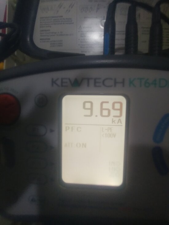

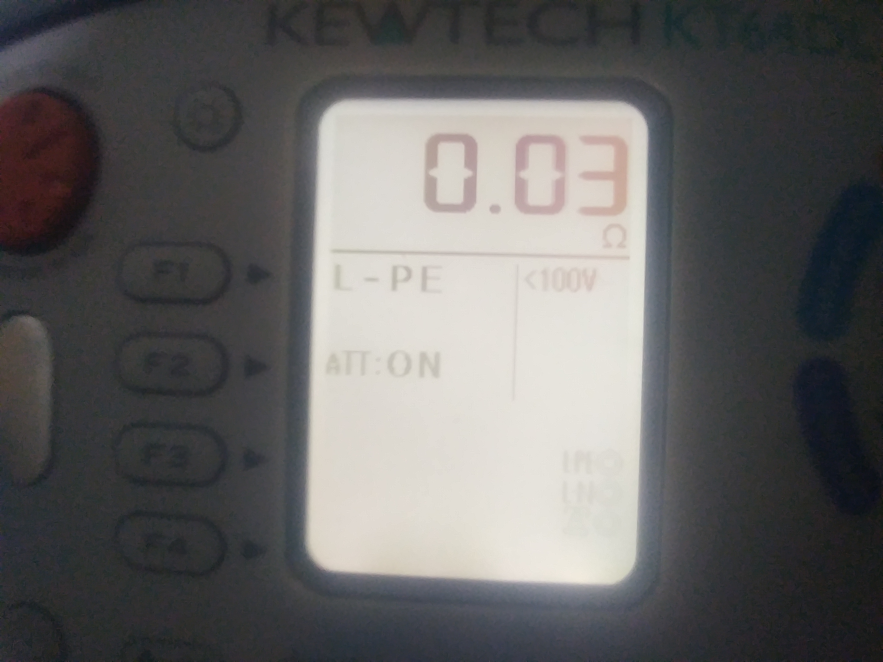

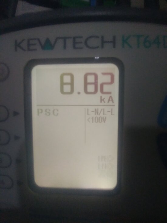

On a job today and when testing got a Ze of 0.03 ohms on a tncs. Using a Kewtech 64DL.

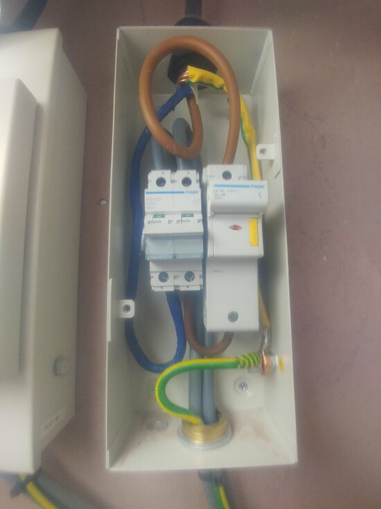

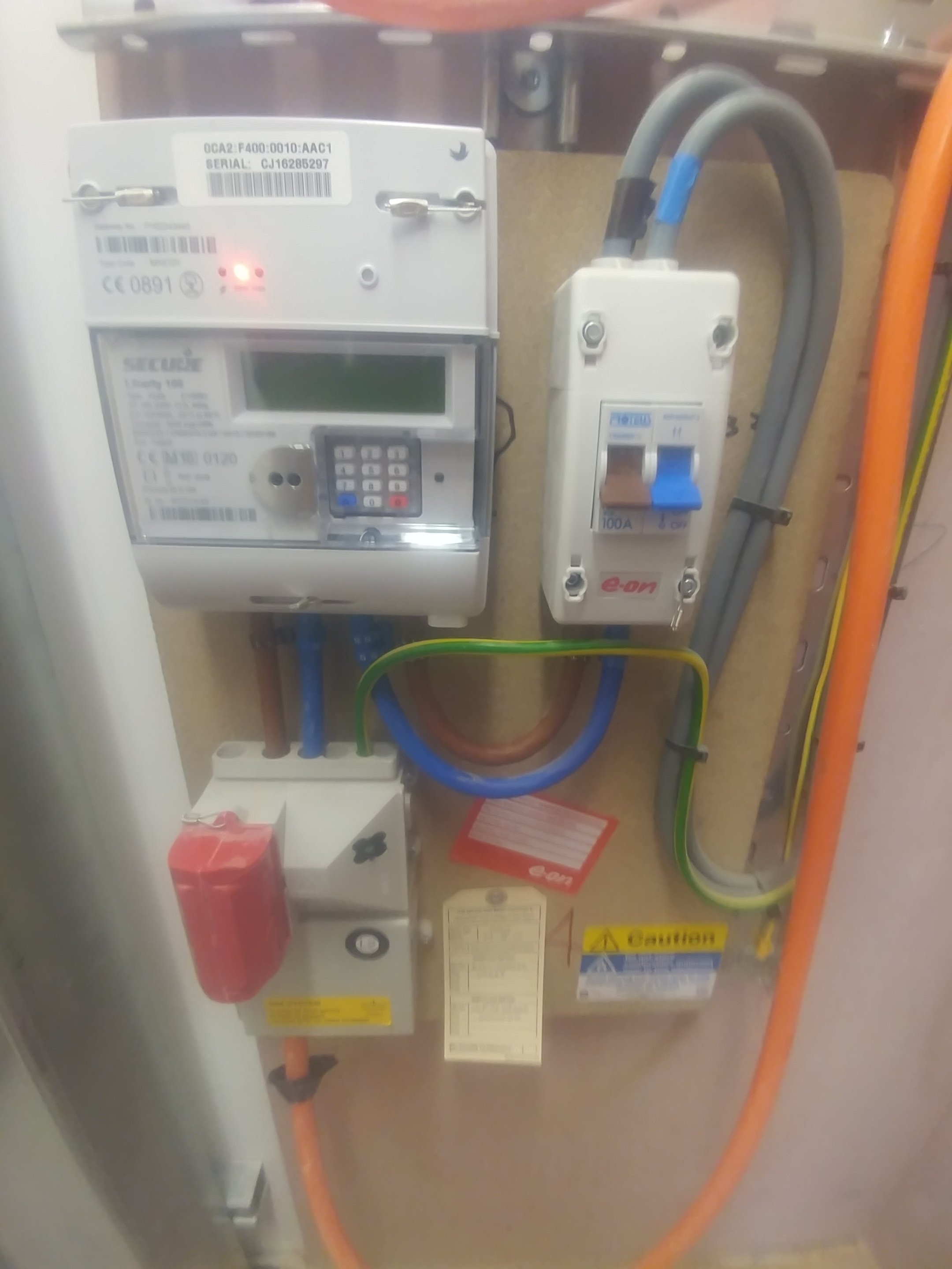

Installation has main fuse in hallway outside the 2 bedflat then a switched fuse feeding a submain cable to the actual CU. I did Ze at both immediately before switched fuse and in CU with earth disconnected each time. Both times got 0.03 ohms even with the submain cable running 6 metres.. given the MFT;s have a margin of error this is a pain, I have checked the tester on a calibration box and it measures 1 ohm fine. it looses half an ohm at 100 ohm reading on loop test according to calibration box.

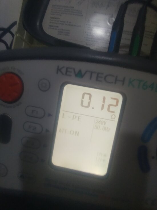

Zs@DB is 0.12 ohms... only utility feeding the property is a district heating system with metal pipes running through building into ground and heating building next door, these pipes are 4 inch diameter into building and around floors into water re heater boiler by flat entrance. the water is fed via plastic pipes. so would provide a very good parallel earth
The building is just over 2 years old and is just up road from the transformer.

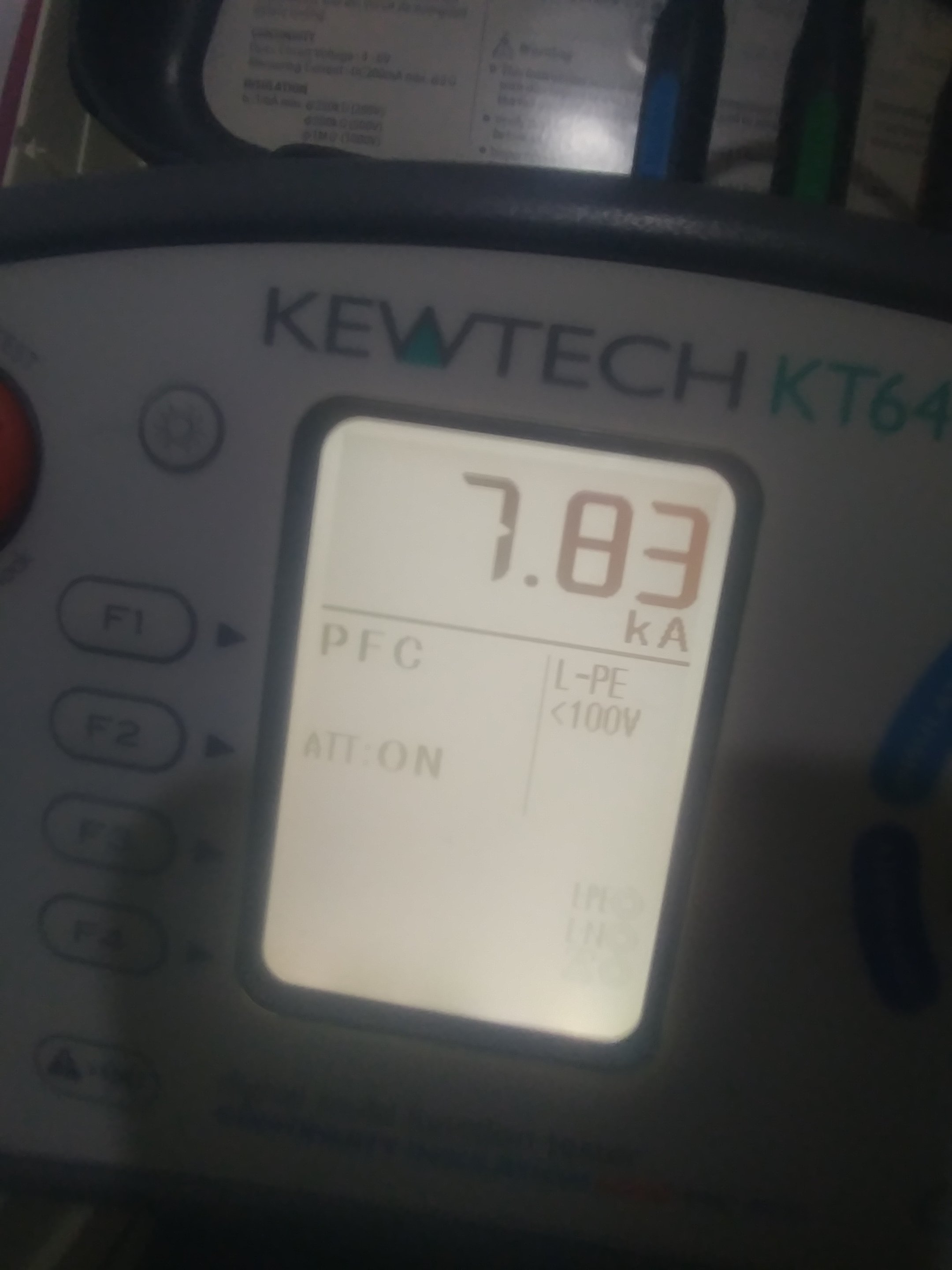

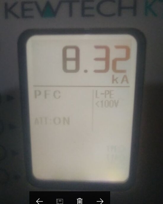

Due to low Ze i am also getting funny and varying PFC PSCC readings which would if readings are correct then i have a very high lpf..... Have attached some images to explain better... Am wondering if leads might be playing up? MFT is only a month old out of the box... might use the R2 lead to add some extra resistance then take it off values when i go back tomorrow.
Any thoughts?

Yes main earth was disconnected as it entered switch fuse enclosure, its shown in the image coming from cutout to the 16mm bolt where it joins the submain cable that feeds CU in flat. i disconnected it here to do Ze and then reconnected and did Ze again in the consumer unit with it disconnected from earth bar.
Last time I had that with a Kewtech 65dl was 0.03 Ze. I spoke with Kewtech tech. and they pointed out of course that is + or - 6 digits which it does say in the manual. I questioned it because apart from the high pfc the DNO had just installed a new cut out and testing with a megger they got 0.11 As kewtech said well if you add on 6 digits you are at .09 which is nearly the same as the DNO. So make what you will of that. All I can say is when you are measuring hundreths of an ohm things get a bit indistinct. And yes the sub station was within a hundred yards.

Looking at the 9.69kA PFC your Ze is even lower if you do the maths, around 0.023 ohms.
As long as the breaking capacity of the OCPD are good then no problem.
However the variance Kewtech claim raises ones eyebrow a little...
0.03 ohms is below 0.35 so complies but my lpf is over the breakers at 6ka are no good if we are going by the regs... think its 432 something off top of my head - might be wrong.. im getting varying pfc and pscc readings even with tails held in croc clips rather than probes.... only difference being i press the test button again! ; i suspect either the MFT is not reading correctly or within its margin of error.

sorry .. 0.03 ohms is Ze measured at both the switched fuse and again in the flat , each time having the earth disconnected, the first time at Switched Fuse and the Second at the earth bar so really Ze@db. the 0.12 ohms is Zsdb in the flat... which i would expect to be higher given the large metal pipes that feed the heating system across the development which are linked into the earth bar with a 10mm earth cable.

are your leads okay? might sound stupid but I got in a right muddle with my KT63 last week! was testing sockets in a house and getting 0.73 zs on one socket, then on others on the same ring stupidly low readings like 0.03 and massive kA!!!! I would have thought dodgy leads should have increased the reading but for some reason it didn't! cracked out some fresh leads and everything stabilised and all sockets tested near enough the same at 0.73....
with the substation so close though its entirely possible that it isn't reading too far off!
okay 0.03 ohms is the Ze i get whether i test Ze at CU or the switched fuse as its technically origin... the 0.12 ohms is ZSdb which given the flat is serviced by huge metal pipes for the district heating which are bonded its got a parallel path of some substance! the heating system has a boiler type thing which is fed by the pipes and if i run a continuity test on the boiler pipes i can connect to one next door in their cupboard and get a beep.
