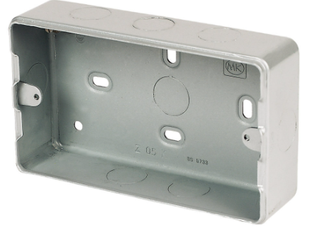

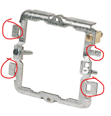

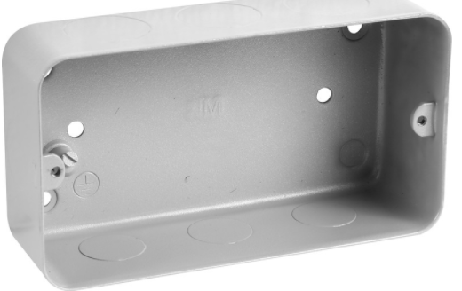

I agree the hole spacing is the same....but don't the lugs on the side need a recess to fit into?
What I have in mind is that for surface clad metal boxes you have to get the right one as there's one that doesn't have the recesses for the lugs.
For example, the 3/4 module grid doesn't work with this MK Metal box...
but does work with this one:
Is none of this an issue for the drywall back boxes?
Really, you could fit the drywall box and file small indents into the box for the frame lugs to fit over couldn’t you?
Hi you just fold those parts back with a pair of pliers. This is the case for flush mounting any of these.
