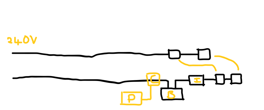

An idea for you. Instead of running in a very long thicker cable to solve the voltage drop and power delivery problem, what about installing a Solar PV, battery and hybrid charger-inverter system at the location 800ft from the mains intake? See my outline sketch attached. Your required voltage, frequency and power is generated locally ie: at the 800ft location. The long run remains and is only used to charge the battery when solar alone is insufficient . The sizing of the solar panels and battery system depends on the power you require and the daily energy consumption and load profile of the pump(s) and RV etcetera. The battery charging scheme is over say 24 hours so can be at a lower current so less voltage drop. The high power/current requirement is satisfied by the inverter and battery. Solar PV of course will allow you to economise on your mains electricity bill. Voltage drop is now only a problem between the inverter and its loads (100ft?).
B = battery I = Inverter P = PV panels C= Charger
