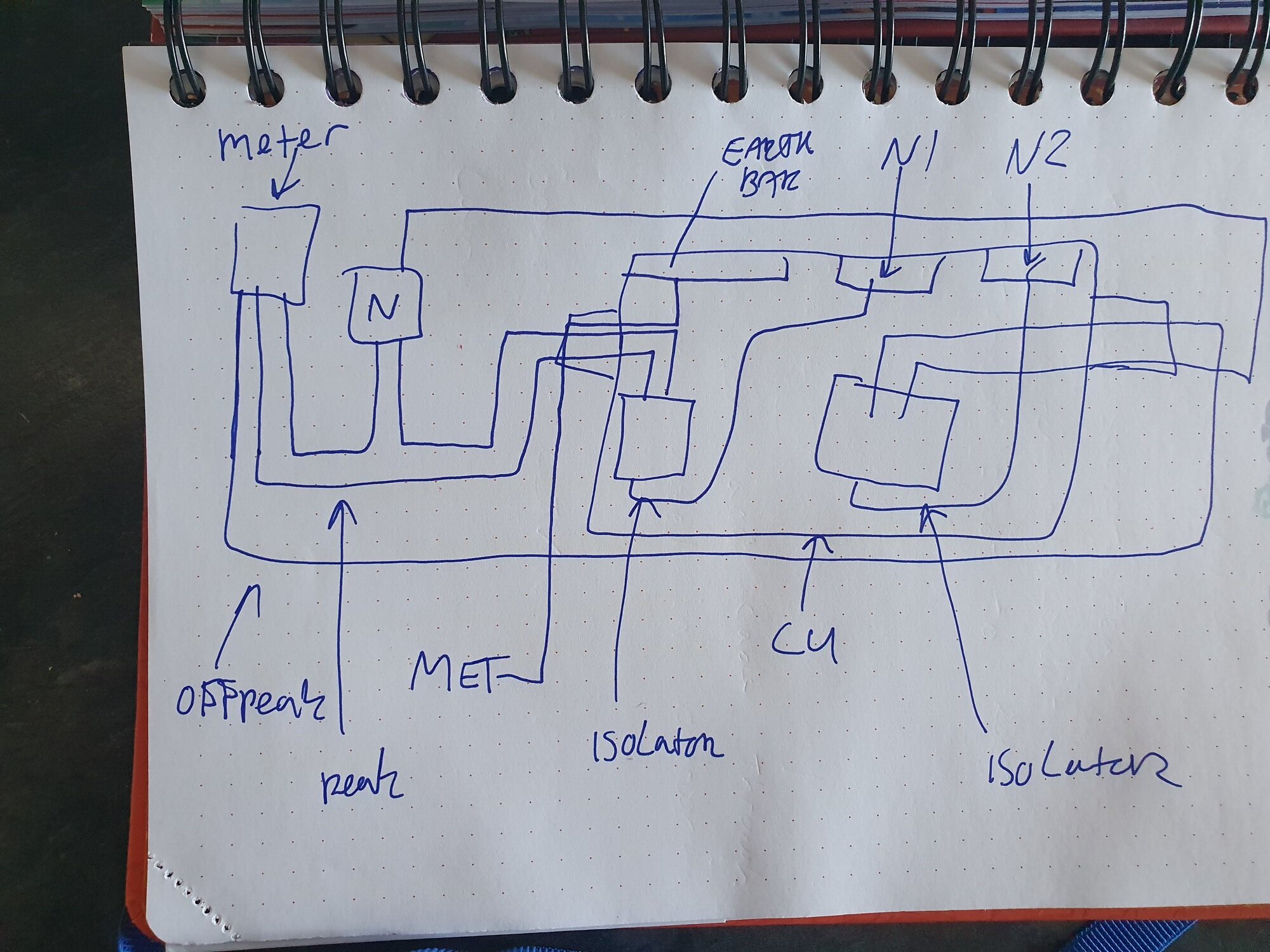

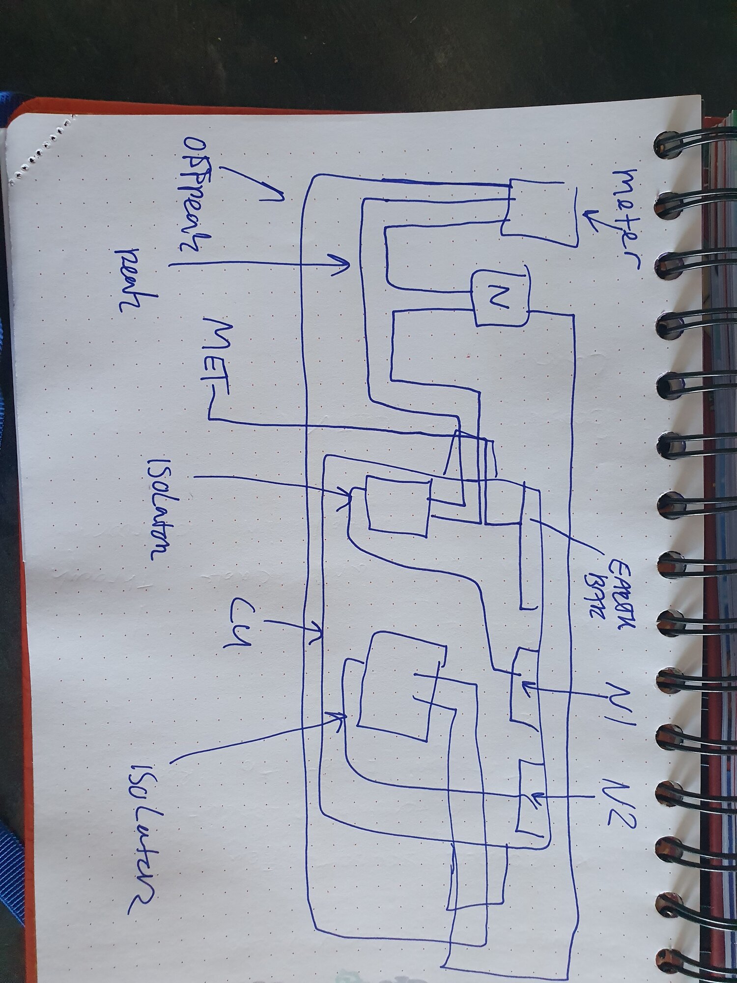

Is a board layed out like this correct for an eco 7 off peak supply and a peak supply?
Two isolators that feed seperate rcds.
They have a shared neutral which is split at a Hanley block.
The peak live, neutral and earth enter the cu via one gland,
And off peak live and neutral enter via another with no earth eddy currents?
They have split neutral bars but share the same earth bar...
A single isolator in the board to isolate both supplies
Common MET and separate neutral bars
That's the way I always did them anyway
Wouldn't you need a 3 or 4 pole isolator for that?
Or do you mean for an installation where the switching/timing is done by the loads, not by the meter?
Fusebox do a dual tariff CU that can be configured as per your sketch.
nobody's said "No" yet ?
For the off-peak feed in, as long as L + N go through the same hole, the fact that E doesn't is not a problem, given there shouldn't be much current flowing in it!
I see , 2 DP isolators
That wouldn't be allowed here for 2 supplies into a distrution board .
I would agree that you really want a single point of isolation for everything, so if it were me I would look at using a 4P switch (even if one pole is unused, depending on just where it is located.
