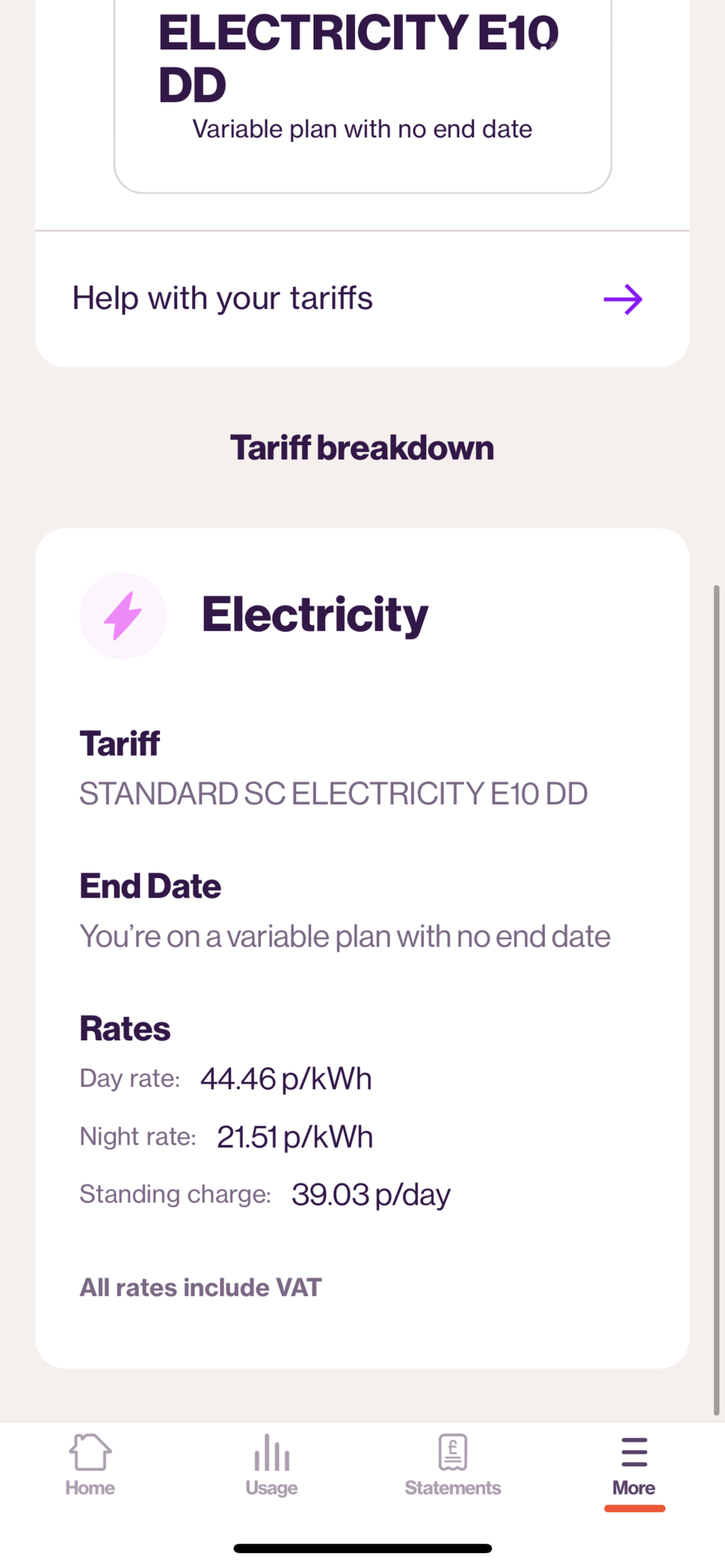

Do you have an actual off peak tariff with your supplier? Your bill should have 2 rates.
Thank you - Yes I do , see photo attached. This is another reason for my confusion. When I base my calculations off of these tarrif i.e. applicable wattage x hours of usage x p/kWh …. It isn’t adding up… so something somewhere to me is wrong ?

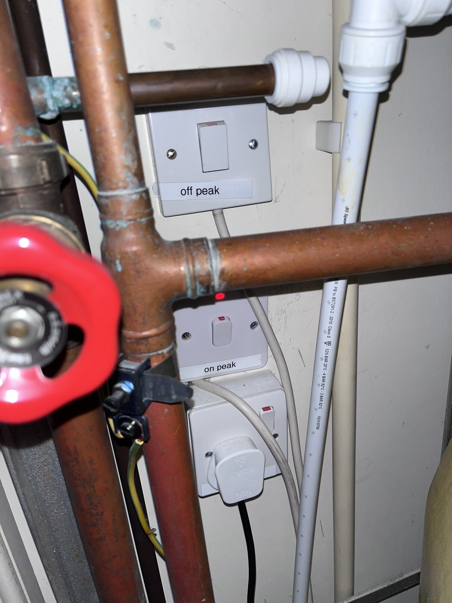

Sorry when you say ‘the power should be off peak’ are you saying mine is wrong given on this photo the bottom one is on peak?
Do u suggest that I switch one of them off? As I am under the impression - like you say - that one of them should be for a ‘boost’ e.g. you have guests and need extra hot water….

I couldn't tell by the photo which immersion is connected to which switch.
An electrician should be able to tell which is which, even with a non-contact detector would give a good indication.

The E10 tariff would mean 7 hours off peak overnight, and another 3 during the day.
Depending how its all set up.... The older systems gave you cheap rate on all your electric overnight.... Newer ones, just the heating.
So the Hall Heater on the 3rd circuit could be on high rate all the time.

As noted above Off Peak is probably 7 hrs overnight and 3 during the day.

Thermostat adjustment behind these 2 black knobs - circled in green on photos attached.F8CAE51A-911B-44B1-8FC1-9FFB4EDB7A5B.jpeg
Hi MeganS
In relation to the two switches "off-peak" and "on-peak" connected with white wires to the immersion heaters, could you follow the cable from the bottom switch and check if it goes to the bottom or top immersion, and similarly the other cable from the top switch goes to which immersion?
I am puzzled by the fact that the light is lit on the bottom switch - did you take the photo during the day, or at night (or to be more accurate, during 'off-peak)?
It would be good to know if the switches are labelled the right way round, and the above might confirm!
