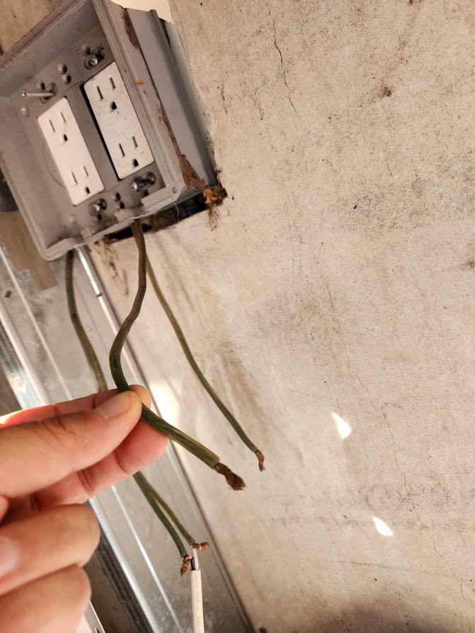

Hi Friends,
I bought a house and trying to add lamps to the outside. There are cables wires all around my stucco walls and the end of them just lie close to a plug. I was going to add a plug head and simply put them into the plug and also bought 8 6W lamps 110V that will be added. I was wondering if the current cables can handle 110V? I have attached the wires that will go into the plugs, but wanted to see if this cable could handle 110V or is it more of a low voltage cable ?

Those wires look like fixture wiring so not it is not approved for what you are doing. You need at least # 12 UF romex.
Fixture wiring is small like # 16. I could be wrong but in your picture it looks like smaller than # 12 wiring
Is there a way to know if the wire is 12 or 16 ? I dont see any writing on the wire itself.
