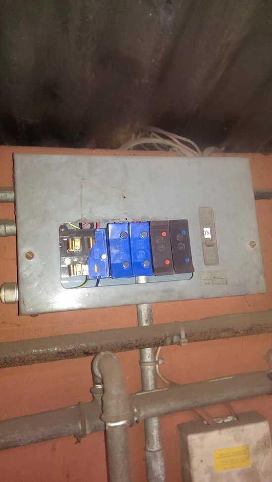

Was looking at a job for a customer who wants existing lighting replaced. Like for like replacement.
It's a TT system an I've noticed there is no rcd protection! Customer said there was an rcd at a time but got another spark to replace it with a main switch because it kept tripping when a steam cleaner was used! I have made them aware that the installation is dangerous and not up to regulations.
Anyway is it my responsibility to put rcds in if I change the light fittings?
Whole installation needs updated!

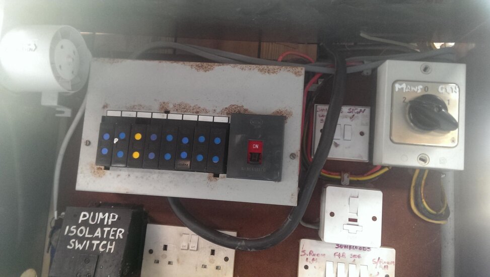

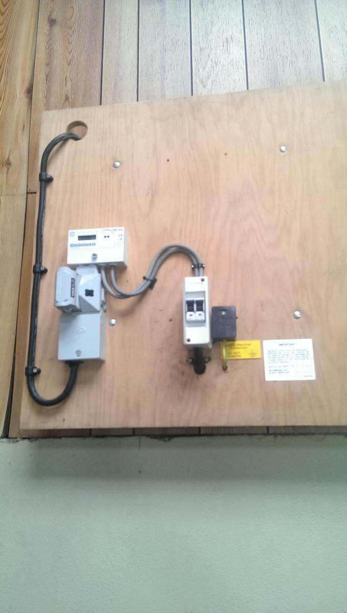

Sod that. Metal CCU, metal conduit, etc and no earth fault protection if you've already established the Ra isn't low enough to achieve TN values. I wouldn't risk my liberty over a job that would probably be worth under £100.
Hardly seems surprising the original RCD was tripping!
That looks like a cheap Inline fan with no ducting extracting right into the Meter Cupboard in Pic 2 :O
It's an absolute shambles! No it's hi-tuf cable. I said to the client if you had a burst pipe you'd have a plumber out straight away. Just because you can't see electric doesn't mean it's safe!
Absolutely dreadful. I have never seen anything like it in years, bloody illiterate idiots. Maybe they meant the ISO was going to be implemented later?
I don't think it's appropriate simply to change the lights knowing the installation isn't up to scratch. I get the feeling the client knows it isn't simply a case of swapping like for like, otherwise they'd probably be doing it them self.
What kind of property is it? Is that someone's house, or a business?
If they won't agree, change the light, do a MWC outlining the issue, and submit with your invoice!
