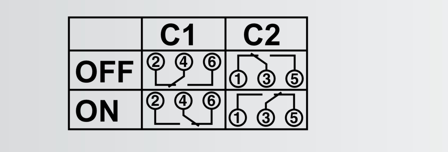

I have 2 lighting circuits that i want to wire into this time clock but not sure of the wiring.
Schneider CCT15720

Now i assume the 2 4 6 terminals are output terminals.
All i need to know is where i take the 2 lives from the lighting circuits and do i have to take a live down from 'L' to one of the terminals like you do on other time clocks?

Thanks for reply, i did see that but i just didnt think that the schematic was very clear on the terminals the cables went too.
From the way i look at it, i would say take a link from L down to 4 and the two lighting feeds go to 6? Would you agree?
or link L to 3 and 4. then 1 light S/L from 5 and the other light S/L from 6.
I can see this is quite an old post but I'm looking after a building and I have one of these units controlling my external lights and its working in reverse, ie- when you set the time for the lights to be on, they're off. Any ideas?

If both sets of contacts are in use, put the wire that's in 2 into 6, and the wire that's in 1 into 5.
Or change over whichever is in use.
