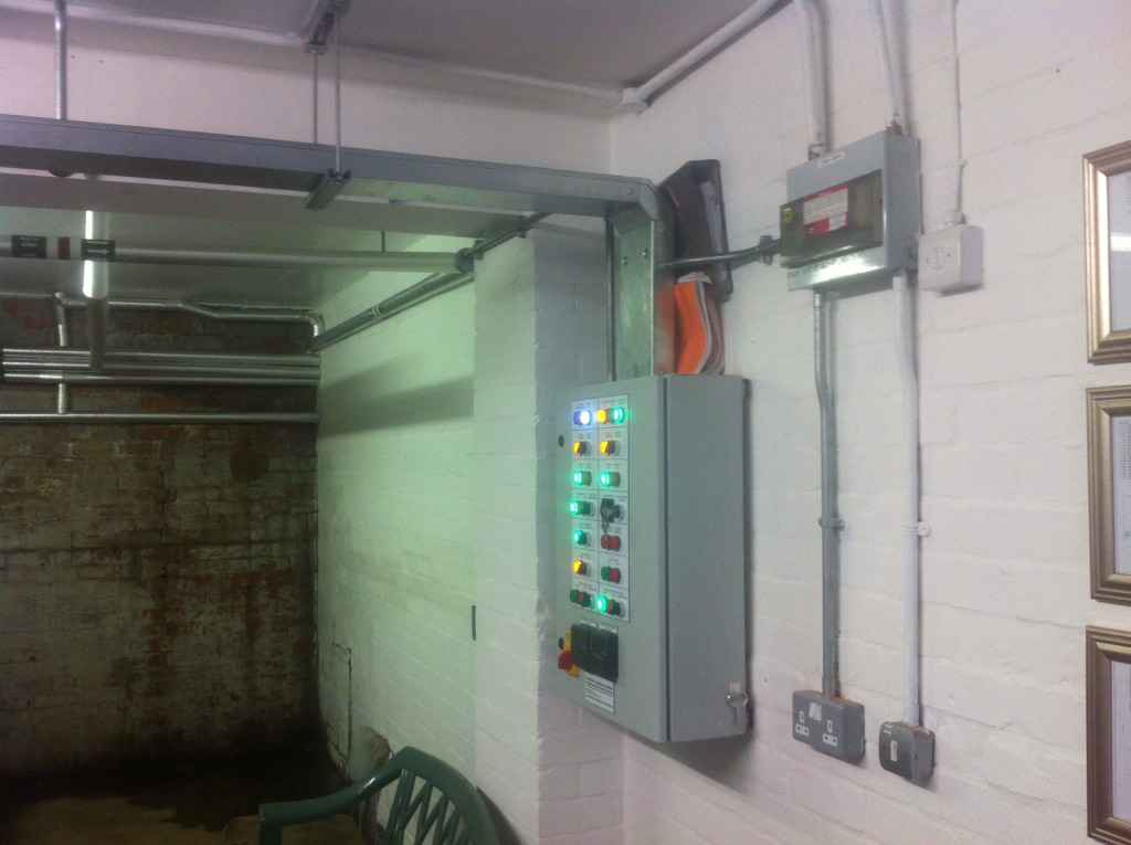

Here's another one with a little bit of trunking around I had done, no sockets this time, and to be honest i don't see nothing not neat because of the trunking,obviously as many people as many opinions. image.jpg
Here's another one with a little bit of trunking around I had done, no sockets this time, and to be honest i don't see nothing not neat because of the trunking,obviously as many people as many opinions. View attachment 19949
Well i think Darkwood summed it up nicely, and i would agree completely. Gaps in the trunking lids only make it look worse...
So tell us what purpose does it actually serve, over and above trunking following the top ''or'' bottom of a CU/DB and maybe on occasion also one side??
Darkwood .... Hmmm... aesthetically it looks crap, functionally having the trunking all round serves no purpose...
Well the purpose as I said already earlier is for the cables to come down from the ceilings and then to go into the CU. Well thanks for opinions! Obviously I'm nowhere near the best guys in here,but I don't think it's near the bottom as well. Learning everyday and hopefully I will be as neat as others:)
Good God! The sparks (I use that term loosely) that you say was round first to look at this "Nightmare" want's stringing up by his B*****ks!!. The geezer obviously has no conscience, god forbid if anyone touched that, even to curiosty minded children. Thank christ you had Henly on your van.
You know the rule get there first , as a "plumber" I always want to get there before the sparks , had one cheeky bugger use all the holes we'd spent a day drilling for first fix .rang him said you've got a hour to get back or am cutting the lot out he just laughed.
We did put it all in one pile for him though
The thing missing is the fire boarding underside of the stairs... electrical fires account for a high number of house fires and if it occurs under the stairs that buggers the escape route up!!!
As a sparkie you should be aware of building regs too and advising the customer i personally would have it fire boarded as part of the job its not a big task and really doesn't need plastering under their.
As a "sparkie" I am aware, you condescending git. That's the problem with this forum, half the time know-it-alls assume that everyone else is beneath them and know far less than they do
It is in a chapel, the grey dust is in fact soot that was blanched by the camera flash.
For the prats out there that have the starting point of "everyone else is a cowboy", the client was advised but as there are two stairs to the gallery, the client decided not to add.
I don't think there is any call for that sort of attitude!!
No-ones saying that you're a cowboy or close to one either.
BTW, if that is soot, then it'll be carbon based, and there's a lot of it too, and as such a definite fire hazard!!

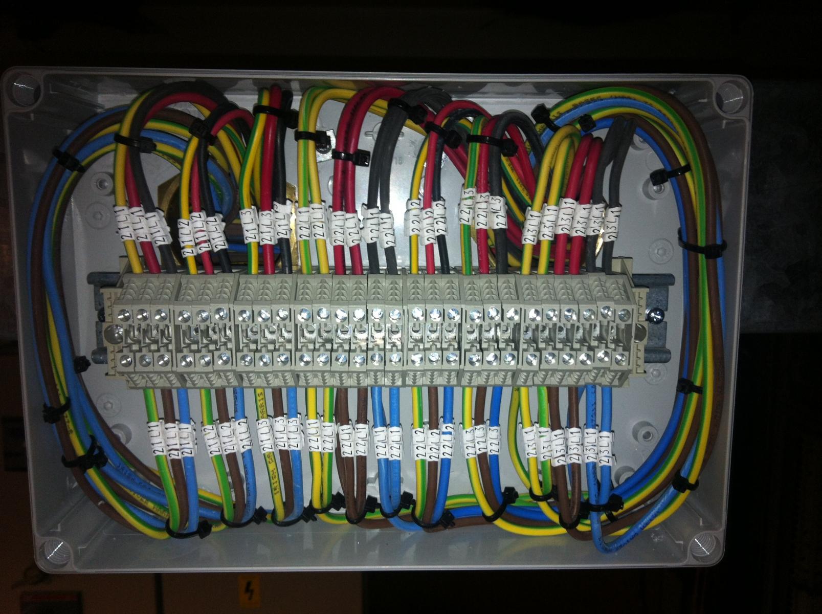

Nothing wrong with the layout i slightly disagree with the separate earth bar comment as this would hinder testing by giving parallel paths on earth as you seem to be extending circuits and would have to disconnect each earth if commoned up here.
My only critique is your core markings as has already been noted you can't have L marker on Neutral and earths as the L identifies them as Live... check table 51
Hi mate thanks for your reply I see what you meen now pal it would look so much better but my gaffa is a mingebag lol cheers for your reply
Apart from the comments on cable marking, that's a neat and well executed installation for an apprentice. It makes a pleasant change to see a bit of care and attention put into a job!! Well Done!!
