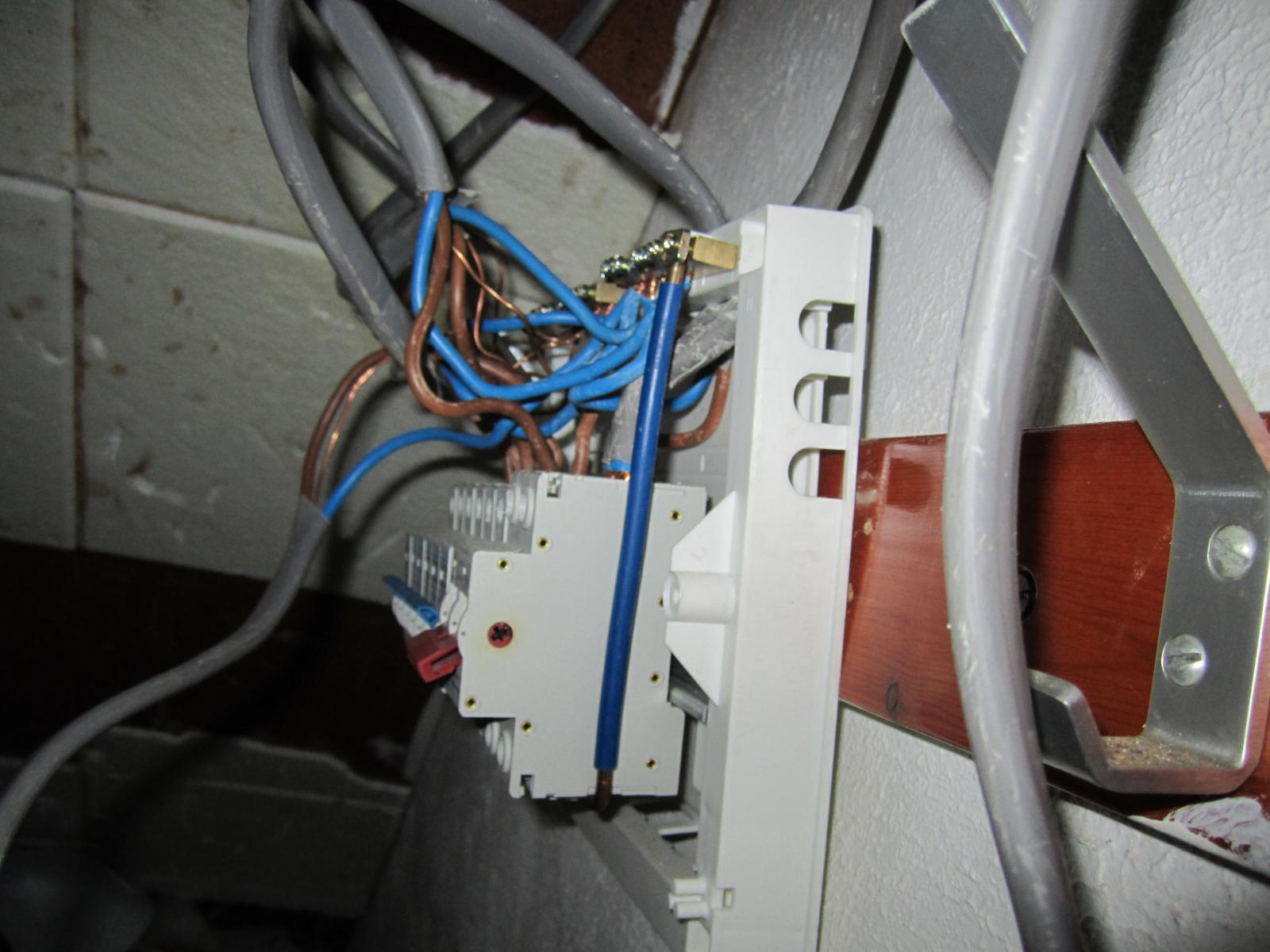

IMG_0889.jpgIMG_0895.jpgWell my first time in a Skunk Farm today.... !! honest.. a rented house that they wrecked and carried out some creative installation work ... no idea where they dumped the meter ;-)
The marks on the switches are whatever debris was on their hands, there had been plenty of plants, peat, chemicals, and some big leaves on the floor.. its was like a scene from Lock Stock... ;-) and believe me the room to room installation was on a par with that board and the contactor set up lol..
