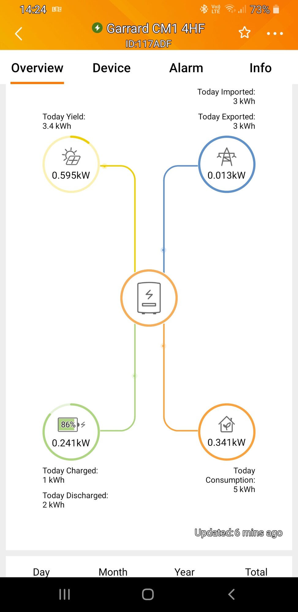

Main issue is as per title: inverter is stuck in Off-Grid mode. I used Self Use over the summer, which worked well, priority PV order Load > Battery > Grid. Now the UK has moved into pseudo-monsoon season, I'm only generating 1kWh/day, so I shifted my loads to off-peak grid hours. This includes direct consumption (appliences that heat water). There's a useable 9kWh of PV battery and I set charge and discharge time windows under 'Time of Use'. Contrary to the manual, all 24h must be covered and "Optimal Income" = Run to apply. Charging off-peak worked well, but the Inverter then proceeded to empty the batteries to the grid immidiately it was allowed (pic). To halt the energy dump and run the house over with my purchased kWh, I set the inverter to Off-Grid. But my house loads are hooked up to grid, so I can't disconnect the grid and run the house.
The inverter response is to discharge batteries at <100W only, use the 1kW PV to recharge the next day, and effectively, the house runs using grid power as if no PV is there (pic). I have reverted all settings to Self-Use as per summer: no time windows, no charge from grid allowed, "Optimal Income"=Stop (pic). Full reboot with all power removed for an hour: PV, Battery, grid. Still it behaves as above and reports 'Off Grid' as the mode (pic).

Thanks! I am no longer stuck in 'Off Grid' and the energy flow diagram has regained the path from the grid to the house. Hurrah! Pic shows PV system disabled.
What I was doing wrong was falsely assuming that selecting one storage mode would de-select the other storage modes. Your advice to disable the other modes manually did the trick: both battery and PV are back online: that's significant progress. Pictures show back to Self Use behaviour.
The inverter response to being in Self Use but with Off Grid left on was to ignore battery storage. The effect was to run the house off the grid only, which the inverter could stop by feeding power to net out the house, but didn't.

Thanks Marconi. I would prefer that the selected choice was blue but Solis decided otherwise, selection is white and the rest is blue. The behaviour I see is that 'Time of Use' over-rides (higher priority) than 'don't dump my PV battery energy back to the grid'. Backflow power = 0W does not stop this. I still have Self Use = On whilst my PV might generate but to stop the inverter exporting my battery gains I disabled 'Optimal Income' today. This prevented immediate export of stored energy after sunset. I throttled discharge current to confirm the behaviour. Before this, discharge time window applied but discharge power was ignored. I think Solis have their priority order wrong. Do charge from grid and don't export to grid should over-ride the time windows of Charge and Discharge.
