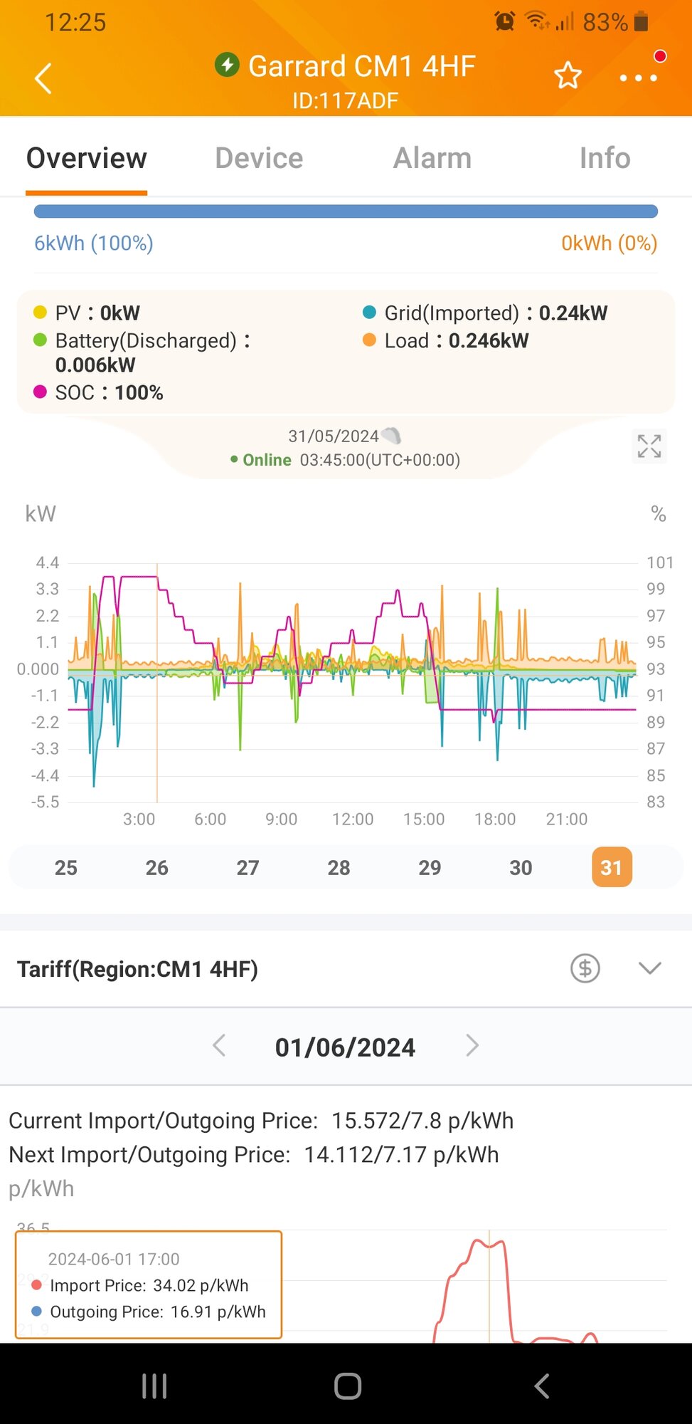

Kit is Solis RHI 3.6k 5G inverter and two LG Chem RESU 6.5k combined with an LG RESU+ box, which is a CAN comms gateway and busbars. I have my SoC clip set at 20% with a grid top-up at 10%. The inverter ignores the 20% limit and regularly drops the batteries to 10%, which halves their life. The Inverter reports this behaviour and does it anyway, which is a costly behaviour.

Where it had been falling over was exporting from battery > load outside daytime. I have two windows set: 3pm - 6:30pm, Octopus peak import rate; and 9pm - mignight, enough for our stand-alone A/C to take the humidity and temperature down in the bedroom. For both, it would get to 90% SoC then quit on battery and import from grid. You can see this in the SolisCloud graphs Screenshot_20240531-095231_SolisCloud and Screenshot_20240531-095231_SolisCloud.
Solis Service told me this was because I had min SoC set to 90%, so I sent them a picture of Min SoC at set to 20%. We were both right, but the 90% SoC was under the 'Battery Backup' storage mode that was set to disabled/off, as per manual: set only one Storage Mode active.
So this turns out to be the answer: with 'Battery Backup' min SoC set to 20%, I get the peak time discharge and overnight house discharge I'm after, plus the cheap rate charge. Personally, I'd say this is a UI bug: having a setting not even visible in the mode I'm using over-ride the obvious and visible same setting in the Self Use mode.

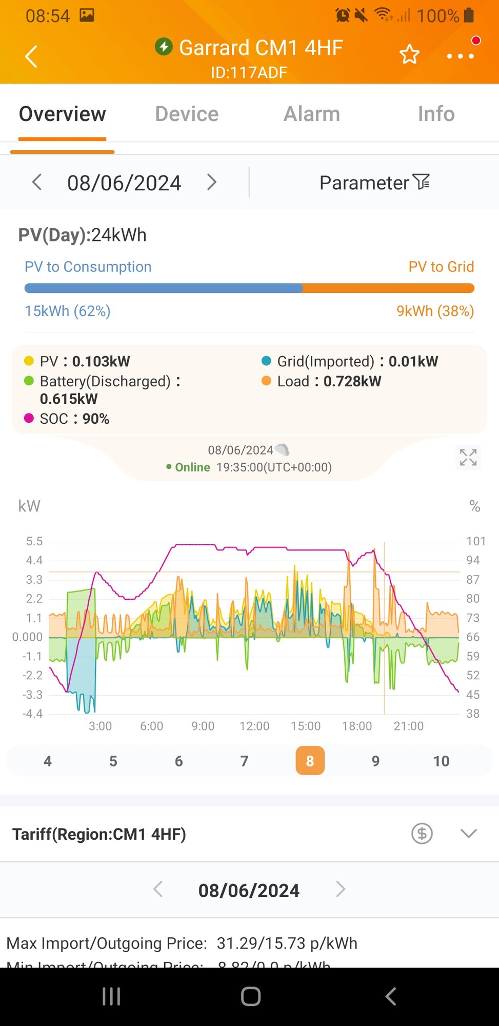

Pictures Screenshot_20240609-085416_SolisCloud and Screenshot_20240611-212654_SolisCloud.
The set Octopus charge window ~1am - 3:30am can drop to single figures and, just occasionally, go negative to -2p or -3p. I have it set so that if it rains all day or is foggy, I still have battery over the peak import hours.
