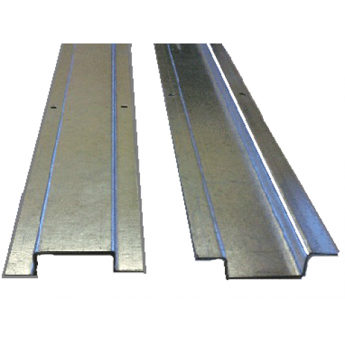

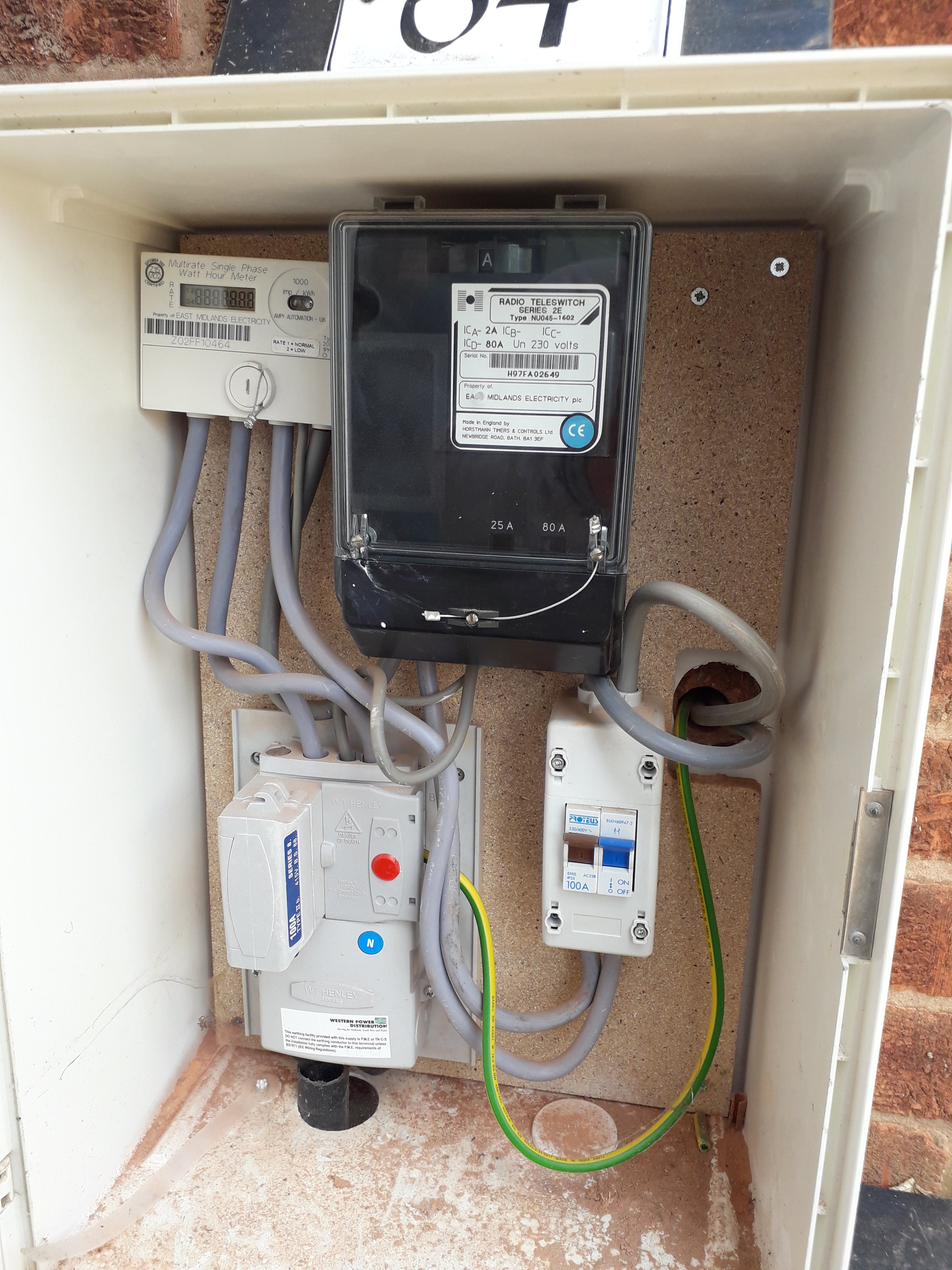

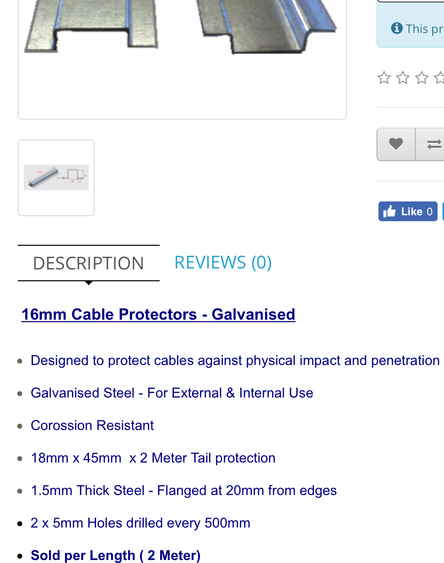

I’ve used it but you can drill through it with an sds quite easily so I’m in two minds whether it compliant for mechanical protection
Hi - agree it’s possible to drill through. I’m thinking that 522.6.204 (iv) doesn’t require the protection be drill proof, just prevent penetration by nails and screws. I’m relying on the British manufacturer who recommends it for this job. Maybe I’m too trusting?
In the end it would be better if the tails were not there in the first place.
