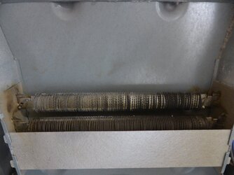

I have attached a picture of the element, me looking at it i would not know if it's good or bad, maybe someone here can?

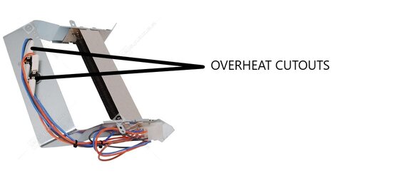

difficult to say, looking at that. if element is OK, main cause is the overheat cut-outs. these are located in the region of the element. they may have just tripped or become faulty. usually can be reset by pressing. a check with a multimeter should trace any problem.

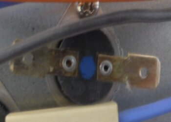

I opened it back up and found 2 x Overheat Cutouts (see piccy 1 as sample).
I pressed both of them and they both felt kinda dead, dunno how to explain it, also one of them was recessed and the other one was more proud.
I used a multimeter (never used one before) and put it on continuity and tested the legs (see piccy 2) and i heard nothing, i done it on the other one and it was the same.
Do you think they are dead?
Is it better for me to buy the whole element as it comes with the overheat cutouts already?
Jay

try a test of the element/s first. you should read about 25ohms. if you are not getting a close to zero reading across each cut-out, then that cut-out is duff. if just tripped, it should click back on when pressed. any cut-out with the same temp.rating should do. onlyafew quid to buy.
