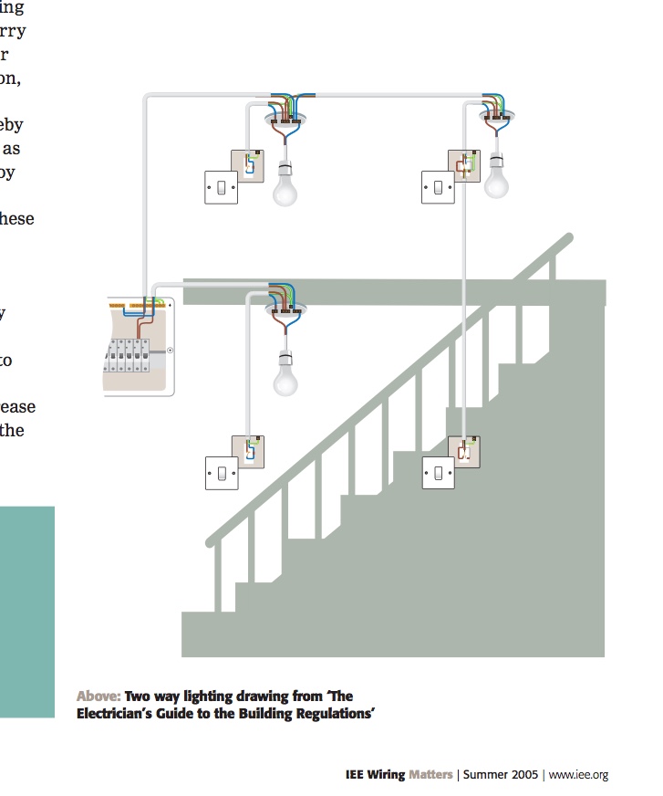

Well, well, well. Just look at the diagram below from an IEE Wiring Matters article. The diagram is taken from the IET Electricians Guide to the Building Regulations.
I think they have 2 radials in one MCB there or I could be seeing things.
Someone better notify the IET that their diagram does not comply with their regulations... :D
Right, thats put that one to bed. Now i'm off to bed...
Without the whole article the picture is a bit useless, for all we know the article could be using the picture to illustrate incorrect design.
