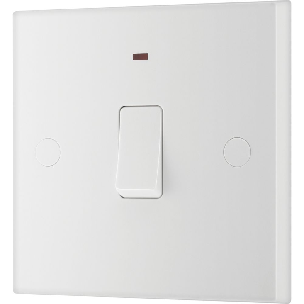

Or just use a switch that has a built in indicator to show it is switched on, such as:
https://www.NoLinkingToThis/p/briti...itch-white-with-neon-with-white-inserts/66238
Not sure how this would work? When the loft switch is on, I would want the loft lights on! Oh wait, i see what your suggesting. The thing is if I left the loft switch on every time the landing lights were on, the loft lights would switch on unnecessarily. But it would resolve the primary issue of the loft lights being left on for months on end without noticing. But the killer is something I omitted to say in my original answer to keep it simple, the landing lights are switched on and off by a pir on the landing therefore when I'm in the loft the lights will time out on me.

But realistically a switch with indicator is a far simpler & easier solution!

Perfectly safe provided lights are both on the same circuit, but a bit strange and confusing to anyone else. I would definitely opt for a conventional indicator on the switch.
Lucien, I'm going to go with this plan for now, I did consider an indicator switch, but it's not much use when the switch is out of sight.

Seems very complicated just for a loft light. Can't you tuck a neon indication in a wardrobe or cupboard upstairs so it's not on show.
If you wired from the loft light switch, through a a switched fused spur (with neon) then onto your loft light, you then have the option to isolate the loft light from the switched fused spur if you found you accidentally left the loft light on.
I'd think I'd rather that then someone turn off the landing light while I'm trying to work in the loft.
