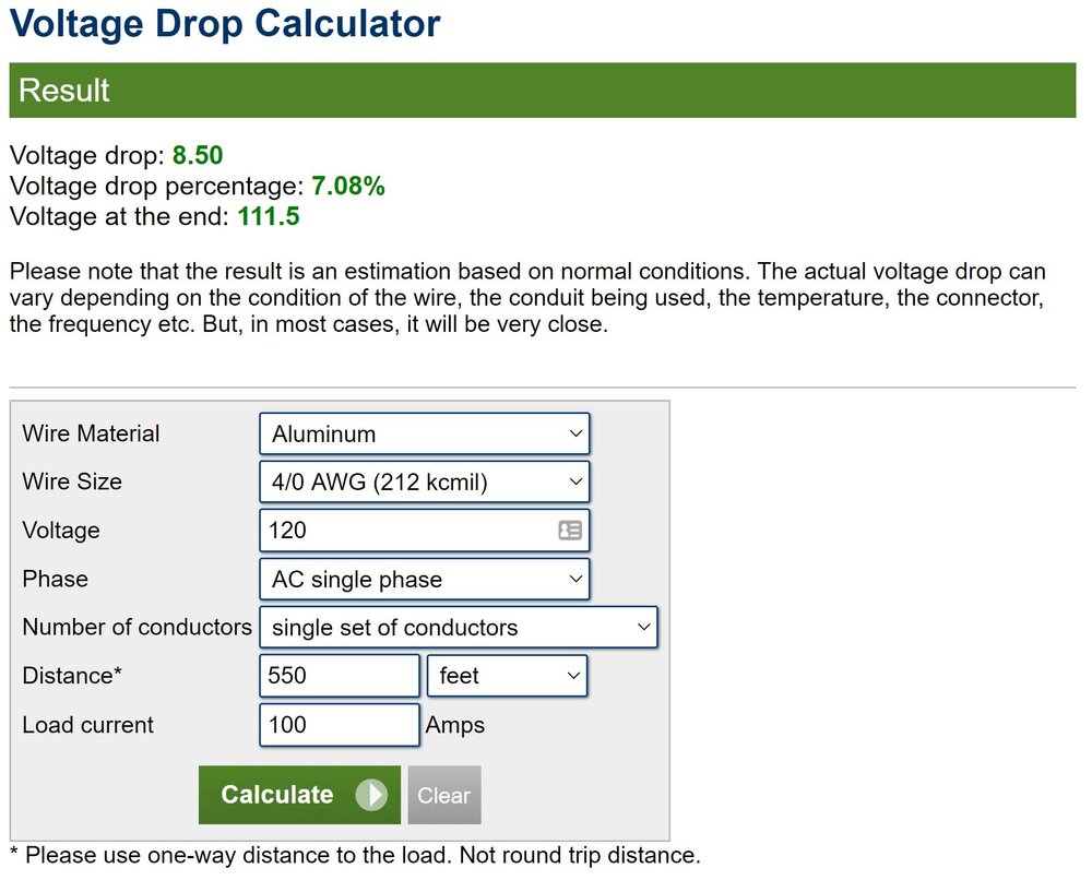

I have attached the calculator where I derived an 8.5V drop in our line at the end of the 6 pedestals. If you get a chance, take a look. I'm not sure what the "Number of Conductors" means. We do have ~100-amps of use, but it is spread out along the line at 6 different RV pads. The calculator doesn't take that into consideration.

As I suspected, the calculator is giving you a figure approaching four times too high; twice on account of the load not all being at the far end, and twice on account of it being a balanced 3-wire circuit not a 2-wire single-phase circuit. So it does agree with my 2-3V estimate.

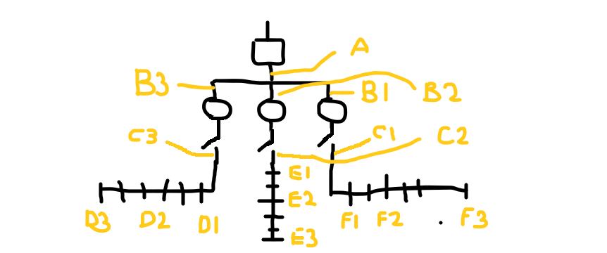

Philbullock122: Only of you feel confident and have suitable test equipment and PPE eg a Fluke voltmeter and Fluke ampclamp could you measure some voltages and currents?
The points for measurements I have shown in the second diagram. The table to fill is in the third attachment.

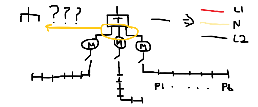

Could you also clarify the wiring just before the 3 meters - see my first diagram.
Last please indicate the places where the neutral is grounded.

Philbullock122: In #1 you mentioned you did all the wiring yourself/selves. When you daisy-chained a run of 6 pedestals did you simply daisy chain or did you introduce a cross-over between pedestals as well as a method to achieve some distribution of RV loads across and along Leg1 and Leg2? Please see my attached diagram.
